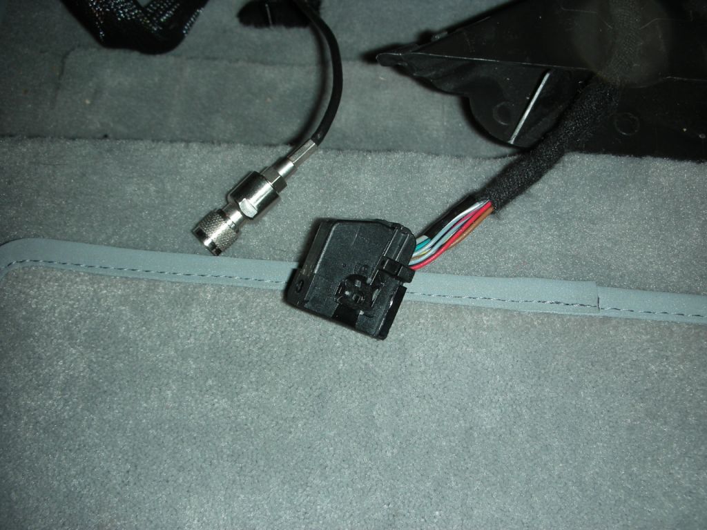

  3. I have a 2005 Cayenne S which has the cell phone prewire option so I belive the loose connector under the passenger seat by the antenna wire is the cell phone connector. (I've attached a picture of the connctor and antenna wire) From what I can see there are the following wires going into the connector. (Red, Brown, Black w/green, Gray w/red, Gray w/white, Yellow w/black, Gray & Blue) I'm trying to verify that this is in fact the cell phone connector and what the various wires are for so I can use them to connect to a Parrot bluetooth kit. Any help would be greatly appreciated. Thanks, Mike
