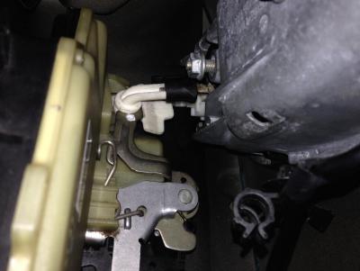

  1. Correct. The problem was ultimately fixed by removing the exterior door handle and assaulting the latch with a large screwdriver until the latch released and allowed the door to be opened. And then a new latch was installed.

  5. What is the secret to disengaging the exterior door handle from the lock mechanism? I can see a white plastic piece that looks like it snaps onto a threaded rod coming from the door handle, but no idea how to free it to the point that I can snap the plastic off the rod. This is the piece just below the partially threaded nut in the picture. TIA for any help.

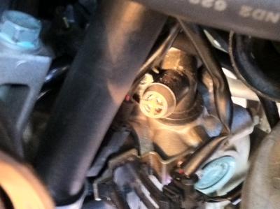

  17. The AOS connects to one side of that fitting, pretty sure the other side is open.

  19. Thanks for the reply. There is no lip, and I did find a pic I took during the disassembly showing that nipple covered with grime, so it looks like it is indeed a breather. Just started the engine up for the first time after the rebuild!
  20. The fitting in the attached photo is on the upper rear side of the 4-6 head. Is this a vent, or should it be attached to something? It's been over two years since I had the engine out, and this seems to be the only thing I didn't document when I took the engine out and I really really want to get it started up this weekend. Thanks in advance for any help!
