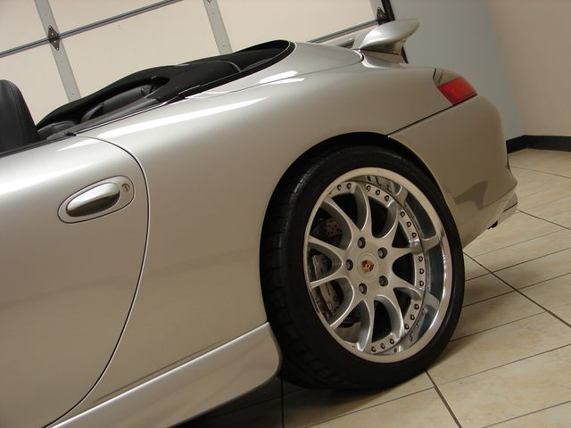

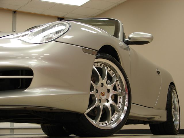

  4. The car in the pictures looks like it is a narrow body Carrera. I will be fitting them on a 996 Turbo so they probably won't stick out as far. Now that I have the make and model I've been able to do some research and they are only available in 19" in the US (in limited quantities) although 18" can be ordered from Germany. I agree that they are VERY expensive but with a bit of shopping around you can get a set for around $3700. Still not cheap, especially for cast wheels, but they do look very good...
  5. Appreciate the help, RG955TT. I've been trying to find out what they were for a while now :) I was seriously considering purchasing a set of hollow spoke GT3 wheels with the 18x12 rears that recently sold on eBay for $1800 but I think that these are going to be the ones I end up with. Porsche seemed to stay with 295/30ZR18s even on the Turbo S rather than fitting the 315/30ZR18s so there must be a reason for staying with the "narrower" tire (probably top speed).
  6. Came across a picture of these wheels and would appreciate any help identifying the manufacturer and what model wheel they are...
