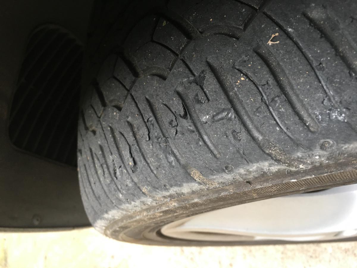

  6. Alignment was set this year. Pressures were within spec. Looks terrible BUT is it a warranty issue?

  8. Went and saw discount tire, and the guy told me that I was taking corners too fast, and that this type of "chunking" is 100% normal. I told the guy of the seven or eight performance vehicles I have owned in addition to the others I've never seen a single tire do this in my entire life, this is my first set of Yokohama tires. Anyone have a course of action they recommend?

  11. Well, 3yr warranty on these is good until 12-21-15. Original purchase date was 12-21-12. Tread depth must be 3/32" or greater. Hope I can squeak it and where on the tire do the measure? Not in the mood to shell out another $1300 today.
  12. These tires aren't that old, tread depth is fine....

  14. Front left and right tires and one rear. It's like the outer edge is crumbling and tearing. I've never ever seen this before on any performance car. I do not drive very much to be honest. I'm a stay at home dad and I go to school and back and to the grocery store mostly.
