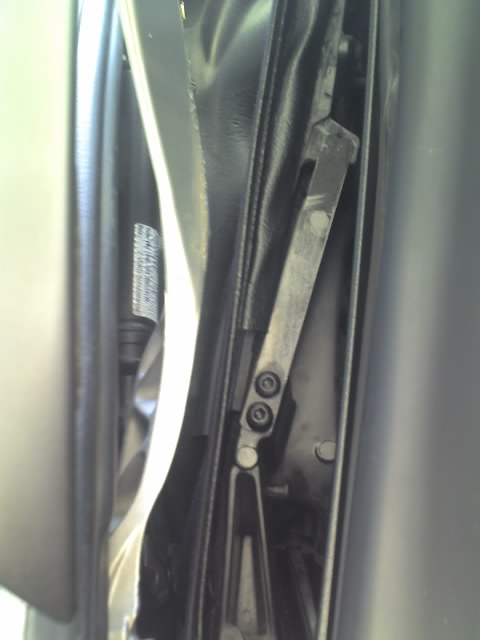

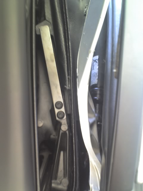

  7. First I want to say hello to all. This is my first post after I got my 2002 boxster in May, a dream come true. I have this problem with my top. As soon as I got the car I went on and ordered a glass window top from Robbins. Coming from a CLK conv. where I could operate the top with the remote it was simply unacceptable for me to do that chop thing. Installation went fine and the new top is great but now I have this problem. When I put the top up, the plastic protectant of the side of the clamshell arm at the driver's side, about half way up, rubs with the tension cable of the top. I removed the plastic protectants to make some space. At the passenger side there is more space so it does fine. I read everything I found about the top's problem s here and I have done thousands of measurements of distances but there doesn't seem to be any difference between the left and right side. The top is aligned perfectly. Also the latch of the top when putting down hits the windstop and the cavity of the storage shelf. All this along with the posts about catastrophic engine failures give me nightmares lately. Thanks for reading and any help is appreciated.
