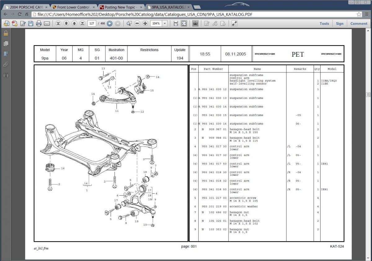

  12. Does anyone have the the torques settings for installing a front suspension lower control arm for a 04 cayenne turbo? Thanks :wrench:
