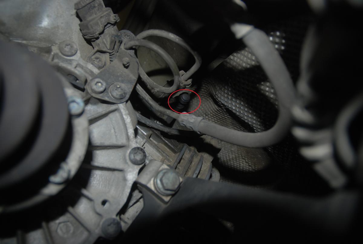

  10. Hi, Boxster 2003, 2.7 here. Did replace the brake fluid using my Motive bleeder. No problem there, very easy. But now I'm looking to do the same with my clutch BUT I can't find the bleeding nipple? I'm looking by the rear driver side wheel. The only nipple I can see is a black one that looks to be plastic and part of the salve cylinder. Is it the good one to use? Please have a look and confirm. Thanks! Thierry

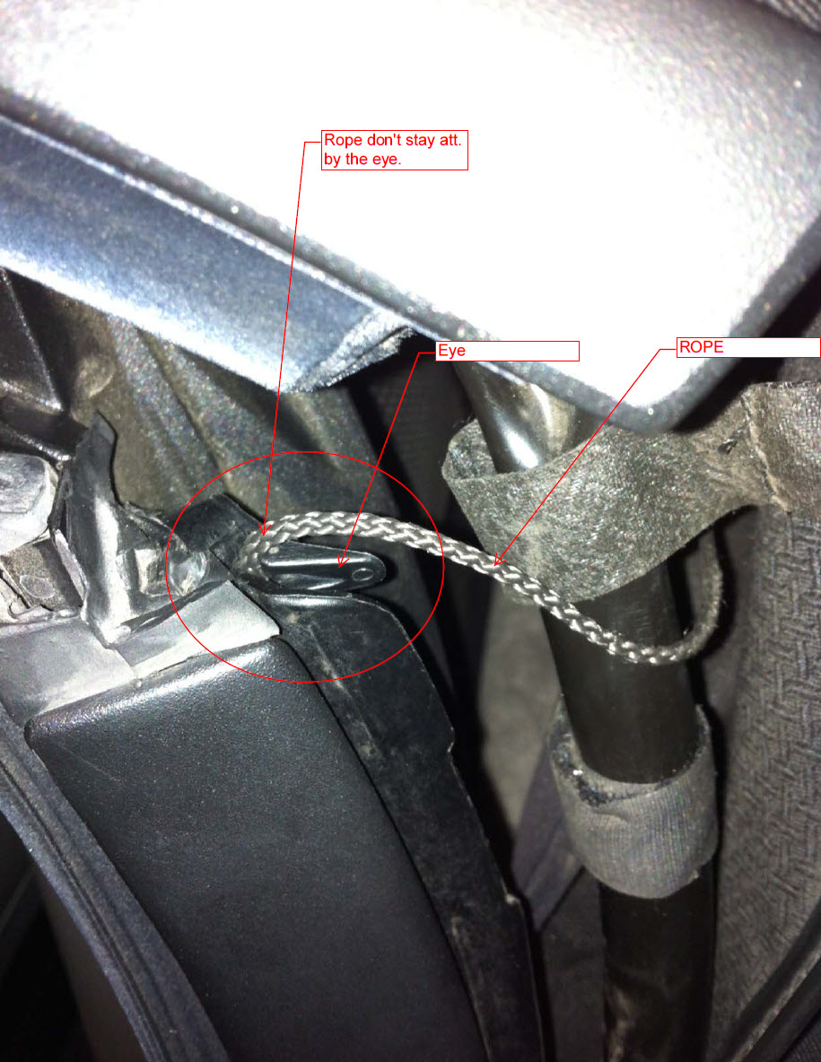

  12. Guys; I had been battling with that roof rope since last year. That rope looks like a shoe rope. It goes from side to side of the roof just between inside liner and the roof membrane. It is attach on both sides to a kind of plastic eye that is screwed with a 15mm Tork screw. On both ends of the rope, there is a piece of sew fabric. Questions: 1- With the roof in service mode, when att. to both eyes, does that rope should be louse? Mine is. (See att. PDF photo). 2- Both ends of the rope don't stay attach to the eyes when I operate the the roof from open-close-open. Why? Is there a solution? Please have a look to the att. PDF picture for more details. Tks Thierry
