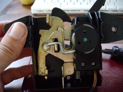

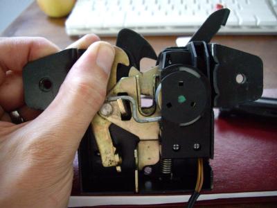

  3. My front hood had been stuck closed for a while. Pulling on the regular lever didn't produce the normal release, and no matter how hard I pulled it up, it wouldn't open. I took the front passenger wheel off this weekend, removed the well lining, and found the emergency release cable. After a few hard yanks on that, I was able to get my fingers under the hood, and open it. One of the problems, I believe, was that the hood was not being raised at all upon release of the catch. I've now got the latch out, but can't really see what is wrong with it. Possibly the spring does not have the right tension. Can anyone tell from the pictures what could be wrong with it? I know, that sounds a little silly, and I'm sure I'll have to take it into my local parts place for them to look at. I don't really want to spend $150 to replace a part that (at least on the surface) looks to have very little wrong with it... Thanks, -James.
