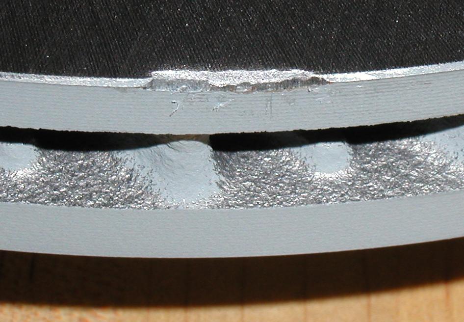

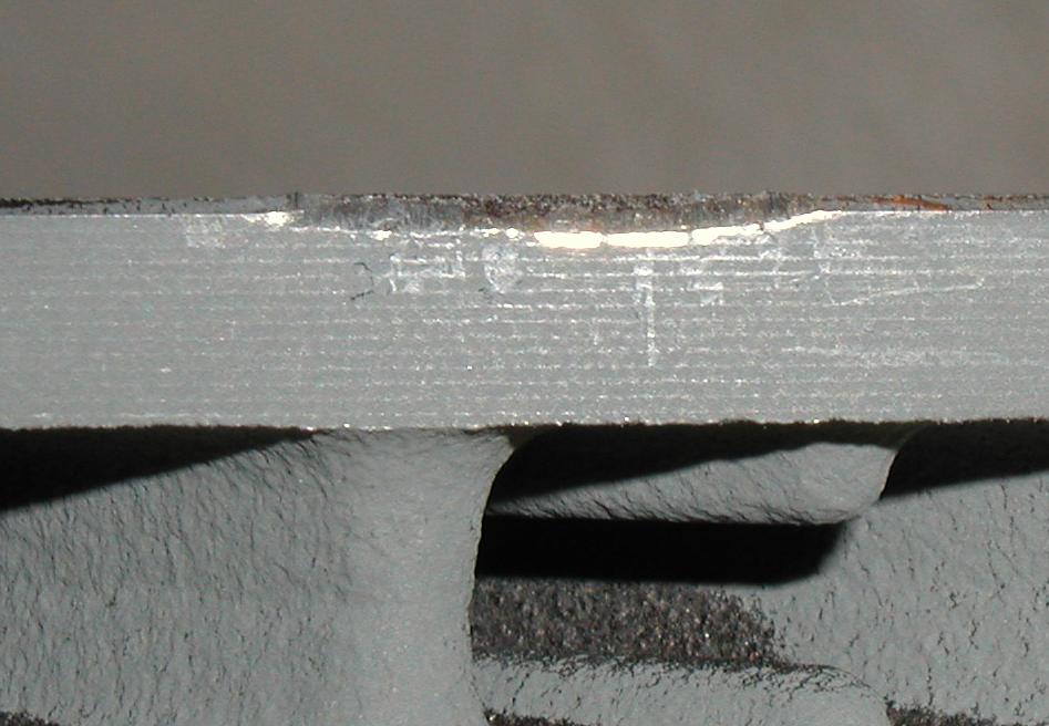

  3. Thanks. The chipped piece shown in my pics is definitely from shipping damage. So, it's after the balancing at the factory. I'm just not sure if it's enough to warrant messing with. Oh well, I guess there's only one way to know for sure. What a pain, I wanted to do this job tomorrow...
  4. Maybe I'm being too obsessive... I'm hoping to do brakes this weekend (rotors, pads and rebuilt calipers). The nearest P-car dealer is a hike, so I ordered rotors and pads from one of the dealers who sells online. The parts arrived today and I was less than thrilled with the packing. All four rotors (inside their factory boxes) were put into one large box with lots of dead air space and a little bubble wrap. Needless to say, the bubble wrap did little to prevent 80 pounds of rotors from moving around. The outer box looked trashed on arrival. I inspected the rotors and three show no signs of damage and using a straight edge, don't look bent. The fourth isn't bent, but has a chip on one edge, pictured below. It's about 5/8" long, but only about 1/16" deep. I think it's out of the way of the pad so it won't interfere with it. But, I'm wondering if this would throw off balance at all? Are rotors even balanced at the factory? Would you use this?
