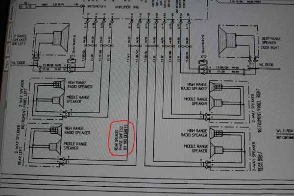

  2. in this diagram, it shows that the rear speaker is phase reversed. is this just for the one speaker that is marked, or both of the rear speakers? what purpose does this serve. i was under the impression that running speakers out of phase was a bad thing. is that just old school thinking?

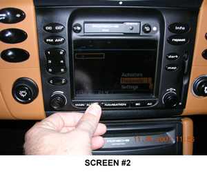

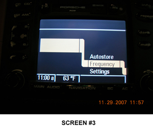

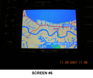

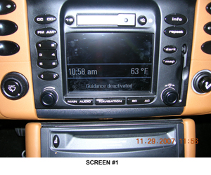

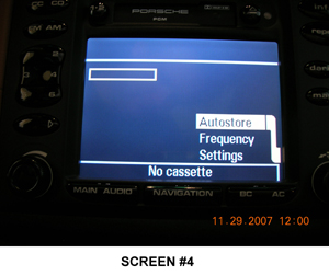

  3. I hope that these pics will give some idea of what is happening w/ my audio system. I have been beating my head against the wall trying to figure this one out. Obviously, I am not smart enough and was hoping that someone out there might be. Screen #1 is right after the unit is powered up. Next, I press the “AUDIO” button and screen #2 pops up w/ “Frequency” highlighted I then press the selector knob to choose a frequency and the frequency field is blank I then choose the “Autostore” function and get a message that states, “Search in Progress”. However, the search is terminated so rapidly that I cannot get a photo of the message. No frequencies are stored and the radio will not function. Cassette tapes are not recognized and neither is my CD changer. I am able to adjust Loudness, Treble, Bass, etc. and those settings are stored. The GPS works flawlessly The AC functions work perfectly as well Does anyone have a clue what is wrong w/ my audio system?

  7. originally, i had a problem getting the pcm to ask for both of the codes required after disconnecting the battery. all of the posts i could find deal with people needing the codes. i have the codes. i had to disconnect the battery several times to finally get the system to ask for both codes, but it did and i have successfully entered both. the problem now is: the audio portion still does not work. the navi works fine. the ac controls show up on the screen. everything is working except the audio portion. the radio, cassette and cd changer are all non functioning. so, i opened the hood,trunk to remove my cd's from the changer and noticed that i do not have any power to the cd changer either and i noticed the courtesy light is out. i checked the bulb. it is fine. i checked the hot and it is fine. i checked the ground and it is broken. does the cd changer share a ground with the courtesy light? just a thought. or, are the 2 totally unrelated? totally perplexed. typhon
  8. originally, i had a problem getting the pcm to ask for both of the codes required after disconnecting the battery. all of the posts i could find deal with people needing the codes. i have the codes. i had to disconnect the battery several times to finally get the system to ask for both codes, but it did and i have successfully entered both. the problem now is: the audio portion still does not work. the navi works fine. the ac controls show up on the screen. everything is working except the audio portion. the radio, cassette and cd changer are all non functioning. so, i opened the hood,trunk to remove my cd's from the changer and noticed that i do not have any power to the cd changer either and i noticed the courtesy light is out. i checked the bulb. it is fine. i checked the hot and it is fine. i checked the ground and it is broken. does the cd changer share a ground with the courtesy light? just a thought. or, are the 2 totally unrelated? :unsure: totally perplexed. typhon
