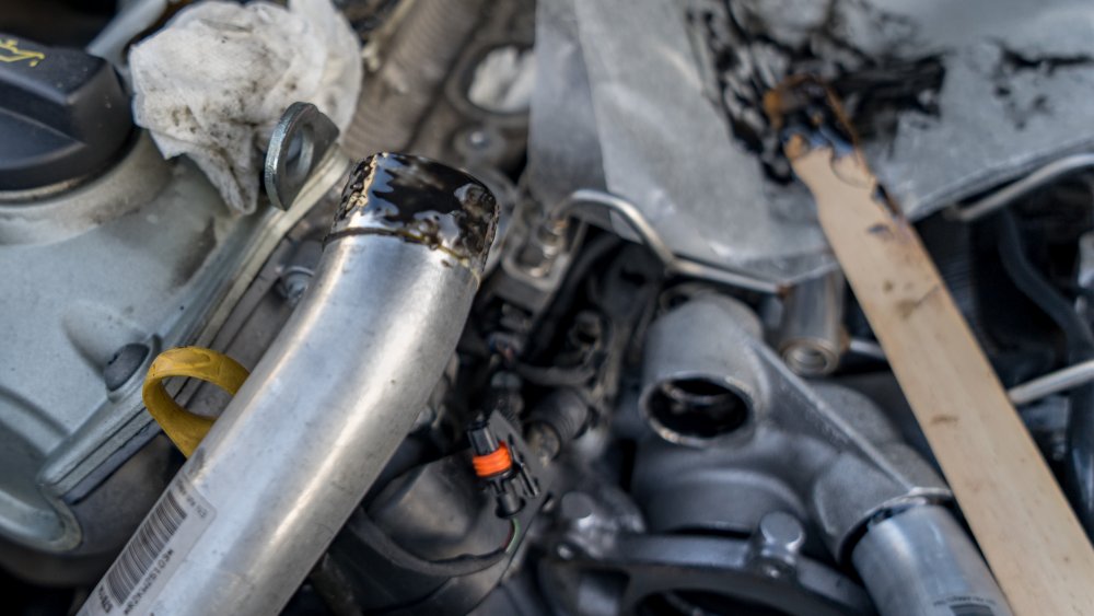

    '68 GTO

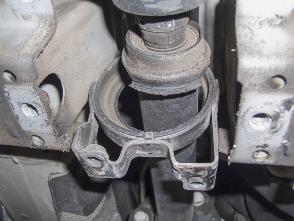

  7. Thank you for the idea, it got me out of a bind and was $0 ...... Car was in at my local dealer last week and they saw the fix.... they were surprised when they saw it, but agreed it was better than spending $2k or so for the shaft replacement.... I have over 8K on the fix and sort of forgot about it....
  8. My 08S with 108k gave me the sudden banging Wednesday during acceleration... thought I ran over something, til it happened again.... Searching the internet.... driveshaft support! Put it into Special Terrain Mode and crawled under to check, yep, shaft loose.... Normal driving and there is no sign of anything being wrong, drove 50 miles home on Fwy before starting repairs.... I'm starting to think my trips to Yosemite are cursed!!! Last year, 1st trip, a coil pack failed (second one) about a half hour out of Fresno on a Saturday morning..... found a replacement and was back on road later that afternoon... (after I got home, replaced remaining 6 coils). A couple month later, back to Yosemite.... leaving the park the first night, the melting snow and darkness hid a big pot-hole.... sudden blowout! (ultimately new control arms and 2 new tires).... The next day, cones in place.... 5 cars had blowouts while I was changing my tire that night! Planned a trip to Yosemite next week and Drive Shaft Support failure.... Fortunately I replaced the Thermostat, Water Pump and repaired the loose tubes in thermostat housing last month. Since I'm limited on time, I decided to go with the hose repair method. Can't really see any reason this won't last for a long time. This shows the rubber support failure: This is where I cut off the rubber support from bearing and housing, leaving the rubber that was attached to the bearing and housing. I had some 3/8" air hose that was just about the right size. I cut pieces 1" (25mm) long and tied together with SS Safety Wire. I think I actually used a total of 13. I tied them around the bearing first, then slipped the housing on at the top first, then used a screwdriver to compress each piece of hose at the bottom to fit into the housing. Once I got the housing in place, I used safety wire to hold the hoses into the housing. I figured the safety wire was a longer lasting product than cable ties. The fix works, no noise, no vibration on hard acceleration.....

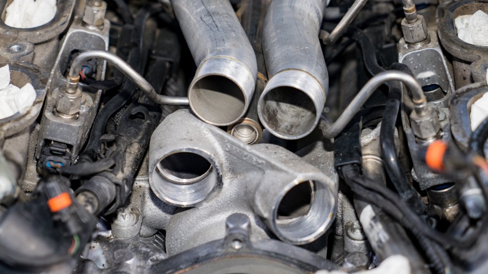

  11. Finished installing pipes in thermostat housing.... One pipe installed and epoxy spread on inside of housing for second pipe... I used the radiator hoses to hold the pipes in the proper position while the epoxy cures. Spread epoxy on pipe before installation... Both pipes installed I'm quite happy with the results..... and saved $300++ Glen
  12. Yesterday I got the pipes & housing cleaned and ready to install pipes....
  13. Guess I'm going to epoxy the pipes back in, both were loose..... Glen Sent from my SM-G920V using Tapatalk
