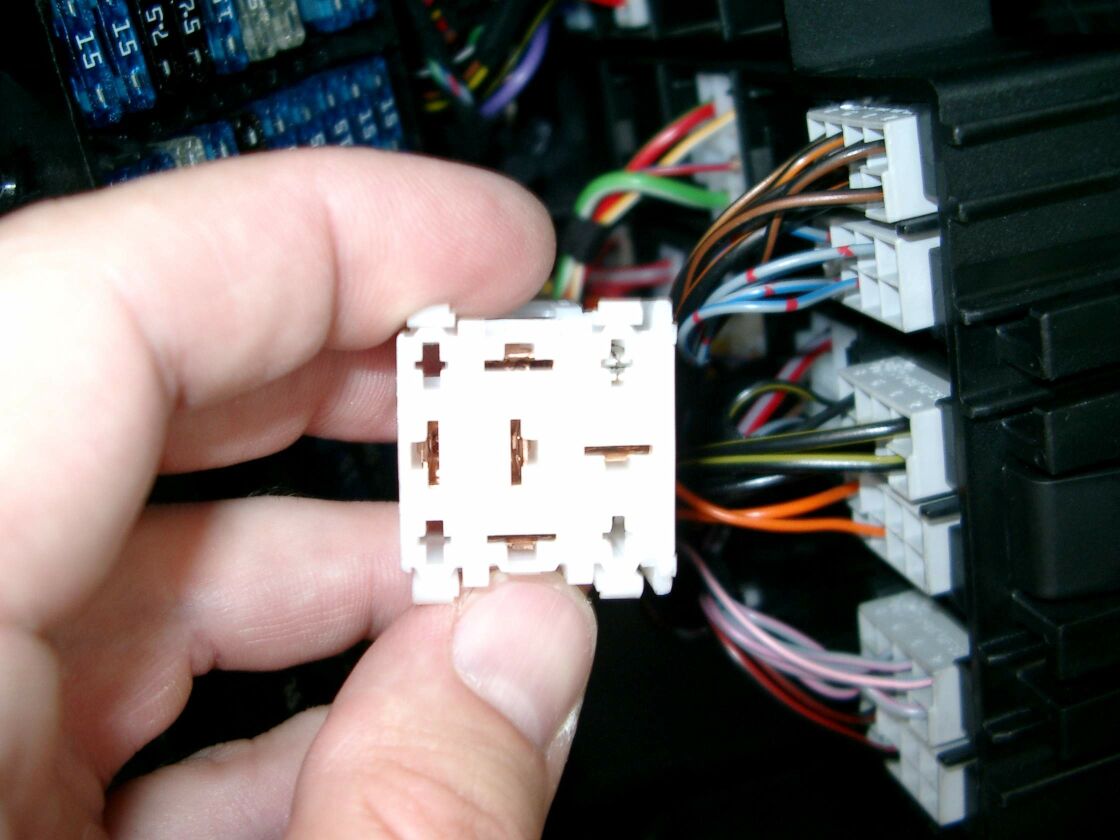

  5. 3. Relais and micro switch After checking the relais I decided to insert a switch between cable and jumper 1 on the relais. This is working great. So I'am able to switch between facturing mode and disabled speedometer signal mode. This is importend for Germany, because we have a 2 year offical car check, called TÜV. If TÜV find non signed modified work on the car they will not allow you to drive any longer with this car. Frank
  6. 2. Relais In my car 996 model 2001 I found following relais:
  7. Hi folks, after cutting the speedometer signal at Saturday I'am happy with the PSE. Before it was real horrible. @Steve: The price was round about 2600 Euro. Please check your EMail. :oops: But while working on the car, I found another type of relais, like described by Loren. For more information I will post same pics about it. 1. Relais-carrier the relais-carrier could be placed in every free space on the board. So it depends on the dealer in which position it is placed:

  11. Hi Loren, yesterday my dealer installed the PSE on my car - and I recognized the problems listed in this task. In Germany the PSE is turned off between 50 and 70 km/h. The feeling while auto turn off was not very fine. With your description it seems very easy to disable the speedometer signal. But before I start to modify the car, please let me know if the doing is the same for all models. My car, 996 C2, was build 10.2002 but it is model 2001 with 3,4l and 300 HP. Can I disable the speedometer signal for my car in the way of your description ? Thanks Frank
