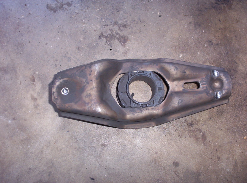

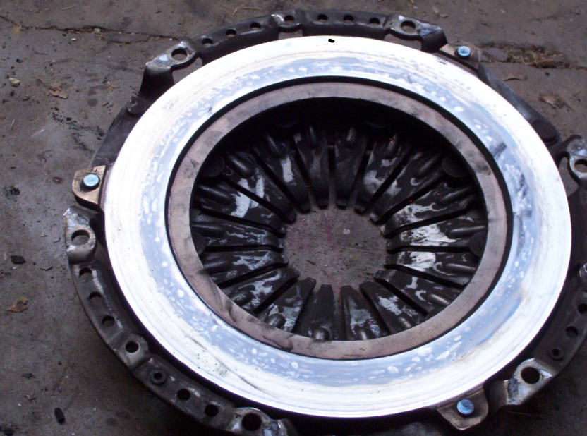

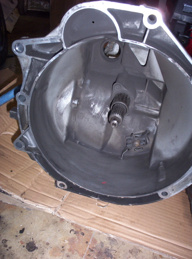

  7. Well i pulled the transmission and clutch and i dont see any damage, however the clutch is used up the rivets were just about flush with the clutch material. hopefully ill put in the new sachs clutch and it will be as good as new oh and there is a line on the pressure plate that looks like a crack, it is really a streak of oil from my greasy hands and while i am in there i know i need to replace the intermediary shaft bolts, check the RMS and replace the flywheel bolts, any other general maintenance i need to do while the tranny is out?
