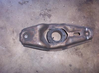

  6. yes i have found that there is an updated release lever, i will be replacing it, i am replacing the flywheel bolts because i will be removing it to update the ims bolts. those are the 2 updates i know of, i have replaced the Air oil separator 6 months ago, so that is ok, kinda would like an aluminum flywheel but dono if i wanna spend that much money, i have purchased the sachs clutch off ebay for $358. I will also be checking the RMS seal, hopefully i wont have to mess with it, kinda scared to touch that.... also since the sachs clutch doesn't have springs on it, if i get the aluminum flywheel will the not work together since the flywheel will no longer have springs on it?

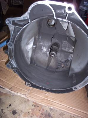

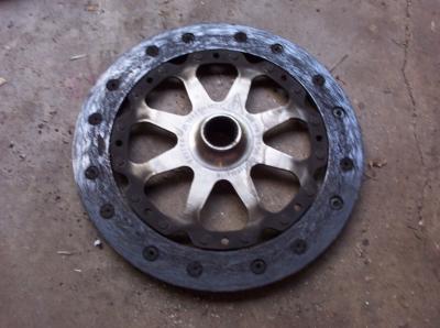

  7. Well i pulled the transmission and clutch and i dont see any damage, however the clutch is used up the rivets were just about flush with the clutch material. hopefully ill put in the new sachs clutch and it will be as good as new oh and there is a line on the pressure plate that looks like a crack, it is really a streak of oil from my greasy hands and while i am in there i know i need to replace the intermediary shaft bolts, check the RMS and replace the flywheel bolts, any other general maintenance i need to do while the tranny is out?
