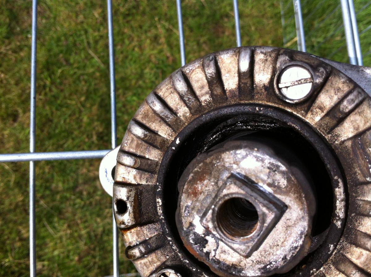

  17. yeah thanks again logray :-) I have taken a pic of the old engine mount which its a little hard to see the cracking all around the bolt, but you can hopefully see. Least now my teeth fillings will stop falling out !
  18. Bingo!! Ok got hold of two engine mounts, when I took the old ones off, I noticed one was cracked all the way around the bolt and was leaking oil ( I am assuming there is oil in the engine mounts) Replaced and voila , no more shaking or rumbling !!!! Many thanks everyone :-) I think I still shake personally from the continual shaking but the car is now sweet, took it for a drive this morning and fell back in love with my car lol
