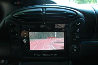

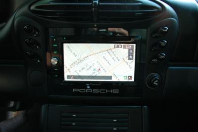

  12. Photos of the Nav unit installed. dave
