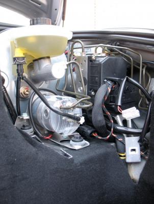

  4. I don't know if this is related but let me explain my problem. I had a very intrusive PSM but no warning except PSM light flashing . As soon I take a curve at hight speed I could feel the PSM acting like crazy! Even in speed lower than the curve can be taken at....Since I got a PST2 I decided to bleed exactly like the repair manual is stating + with somebody pressing on the pedal 10 times (at each locations) before opening the bleed valves and also with a "motive bleeder" pressurizing the reservoir. All four wheels starting with rear right outside , inside, rear left outside, inside, front right outside, inside and finally left side outside, inside but that is where there is a difference, I engage the PSM pump with the PST2 and I bleed the right side inside, outside with this PSM electric pump "on" as per repair manual....No more intrusive PSM after this bleeding process!!!!

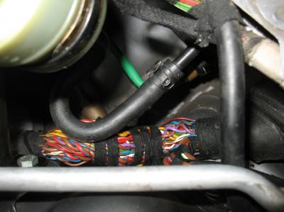

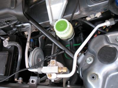

  17. If, on the pic I just added, it is what you are asking for (see arrow), it is only a rubber plug with an opening "funnel type" that it used to serve as a drain if water or oil is accumulated in this compartment.... The other picture posted is to show you the maze of wires is normal.. The other place you should look at is under the fuel access cover. The black cover held with four nuts....
  18. Are you talking about the clutch reservoir or brake fluid reservoir. There is a lot of wiring in both cases. Hope the mouse didn't heat anything in there....
