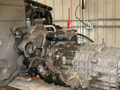

  2. There was some case in the past were the clutch fork was broken. One way to see it, is to remove the starter and with a mirror there is a possibility to see a little bit of the fork movement. Also a slave cylinder failure is possible especially if there was no oil in the clutch reservoir..... The top part on the first picture and the location of the slave on the second picture... Remember the steering pump pressure is used for the clutch operation. Take a look at you steering reservoir to see if the level is normal.

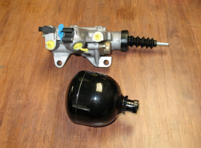

  6. It won't hurt to transfer fluid. I did it for a month before I received the parts needed for this repair. Of course, you probably know that you need to get a new slave (for the fluid migration from the steering reservoir to the clutch reservoir) and an accumulator ( for the hard to depress pedal. Clean up the area properly under the clutch reservoir because this fluid is bad on rubber and you got a big wire bundle in this area that goes to the PSM system....

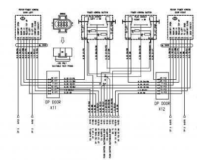

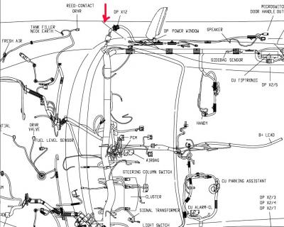

  21. There is only two fuses related to the power window and they are D1 and B6 but if one of those was burnt you would not have any window operating. The first thing to do is eliminate the switch failure. Just transfer the left switch with the right one and see if the switch is at fault. Can you hear the motor movement inside the door??? If not you have to get to the six wires that are going into the door and trouble shoot from there to see if the motor is at fault..... Do the window go down a little bit when door handle is moved ???? Here's the wiring diagram for the power window system. There is only one plug and it is located just before entering the door (DP door X12).... You can disconnect that plug and put a volmeter there to see if you got power... Start with the grey/violet wire and a good ground while selecting the switch to up see if you got 12 volts....

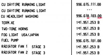

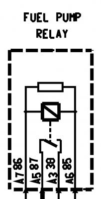

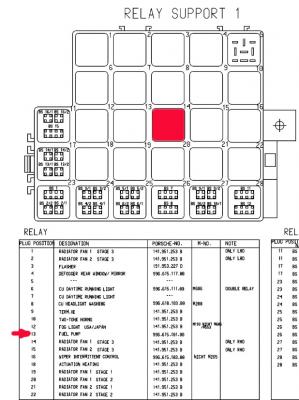

  22. Thanks again JFP. I finally got a proper tool to test the fuel pressure. This is good to eliminate a bad fuel pump or a rupture U pipe in the tank located on the pump canister. The Actron fuel pressure gauge is good Fuel pressure gauge # CP7838 but all the adaptors in the kit are useless for a Porsche. You have to get at the same time for less than $4.00 the right angle adaptor # 01800-000-1299. Just connect the adaptor and the gauge to the port beside the fuel filter and if you got 43.5 to 58 psi it is a good news ;-) (repair manual page 544). Of course you have to activate the fuel pump relay with Durametric to check the fuel pressure without starting the car. Or remove relay #13 from relay carrier #1 above the fuse panel and jump terminal 30 and 87. jpflip: The terminals that you have circled look like number 38 and 87 in the diagram. Thanks for posting the tool and procedure. A blow up picture of the wiring diagram will show you a little difference between 0 and 8. It is important especially when you are ordering relays.... Regards, Maurice.
  23. Thanks again JFP. I finally got a proper tool to test the fuel pressure. This is good to eliminate a bad fuel pump or a rupture U pipe in the tank located on the pump canister. The Actron fuel pressure gauge is good Fuel pressure gauge # CP7838 but all the adaptors in the kit are useless for a Porsche. You have to get at the same time for less than $4.00 the right angle adaptor # 01800-000-1299. Just connect the adaptor and the gauge to the port beside the fuel filter and if you got 43.5 to 58 psi it is a good news ;-) (repair manual page 544). Of course you have to activate the fuel pump relay with Durametric to check the fuel pressure without starting the car. Or remove relay #13 from relay carrier #1 above the fuse panel and jump terminal 30 and 87.
