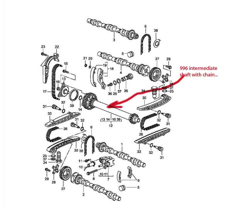

  7. Loren mention an important detail, there is a difference between the 996 and 996 turbo intermediate shaft.996 is chain driven and 996 turbo is gear driven. Completely different design...
