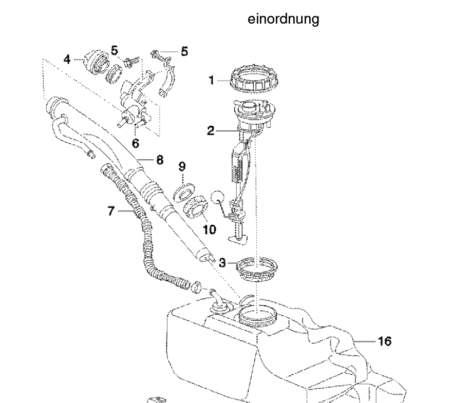

  1. The fuel price in Montreal is changing every day sometimes 2 or 3 times a day....Last night I saw an increase of 7 cents a liter. So I decided to found a fuel station that got the non revise price and rush to this station. But I was unable to fuel <_< I remember reading about fuse E6.... In fact fuse E6 7.5 Amp. was burned. I replace it and got back to the fuel station and it work. All this to save about $2.80. But this money is better in my pocket instead of those petroleum companies...My point is. This morning I've look at the wiring diagram and found out the fuse E6 is for the telephone ???? I went inside the car and got the little fuse plan from the fuse access door and there also they are mentioning terminal 30 telephone info system, OR/VR... This valve seems to be nowhere in the wiring diagram. The only place I was able to found little information was a diagram in the fuel tank removal of the repair manual item#6. I realized it is for the fuel vapor and it is probably only for USA cars. It is called by some a bleeder valve and it is only about $100.00. Anyone ever removed this unit or tried bypassing it with a tool of some kind? Any tought about the wiring diagram flaw especially if you got a telephone installed... Why this fuse blow so often as per numerous previous post about this subject ?

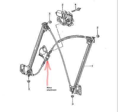

  4. Thanks RFM, but when I am forcing the glass up and down the mechanism of the regulator move freely. Both pulleys and cables follow the movement of the glass. There is nothing loose in the mechanism in relation with the glass itself and the regulator. May be there is a device into the attachment part of the electric motor on the regulator assembly that provide friction. I am really lost on this one. There has to be a brake of some kind or an electric clutch that engage and disengage when window is operating???? Or I got serious damaged gears inside the motor... Any experience in this part of the mechanism?
  5. When I operate the outside or inside door handle the glass should come down about 13mm (.5 inch) according to the repair manual. On the right side it move only about 2mm. Just barely enough to clear the seal when the door is closing. I realized the glass can be moved by hand about an inch up and down. It is loose in the lower attachment. On the left side it is completely tight. So I dismantle the door trimming to found out, the only thing that can go wrong is the window electric motor. Is there anything inside that motor, a brake of some kind, that can be adjusted or replaced. Thanks for your help, J.P.
