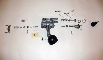

  4. Since a long time I am trying to understand the slave functioning. In the picture you can see an explosive view of the unit. I have found: the accumulator and power steering pressure goes to "Pressure A" of the piston. Which is a smaller area to push the piston. So remember accumulator and power steering pump work together. The larger area which is "pressure B" of the piston got his pressure from the pedal. I understand there is also "W" that I would like to call a pressure differiential control valve. The pressure acting on the spring relocate the plunger to supply fluid somewhere else (I did not clarified that one). Also X and W are also pressure relief valves and that is where I have found a possibility of migration since there was a weak o-ring on the X part. Also my thinking was a migration possibility between the two piston pressure area separated by big rubber rings (pressure A and pressure B part). but they were in good shape. I had to suspend my study of this unit because now I need another unserviceable unit to do some test without having it in pieces. So I have to wait for my valve to fail again :( Or if there is any volunteer to send me your u/s unit I will pay for the shipping since I am located in Montreal Canada....I don't know if this will take me anywhere but understanding a system can lead to a fix....
