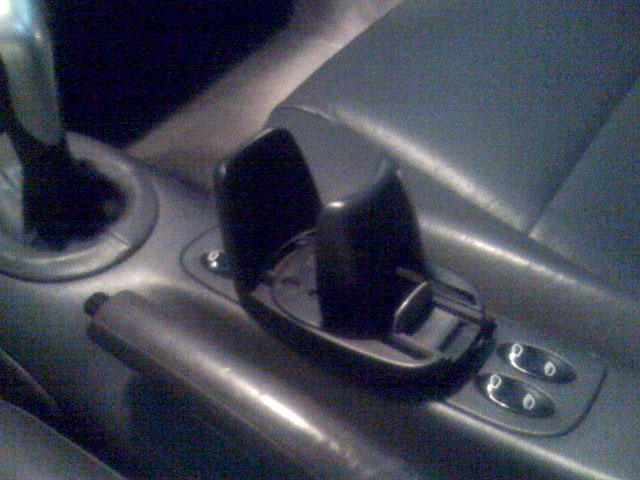

  6. I like that. I was working on another project when I realized that a 1" x 2" board fits perfectly into the 996 ashtray, so I cut one to the correct length and screwed a cheap cupholder onto it. It fits tight enough to handle coke cans and coffee cups, but big gulps are too top heavy. I can slide it in and out of the ashtray at any time. I don't have a photo of the wood base, but I'll take one later. It would probably work even nicer if I sanded down the wood block a bit and glued some rubber over it, but I haven't bothered yet. <img src="http://i178.photobucket.com/albums/w274/jetexasmusic/cupholder.jpg">
