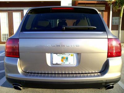

  2. My 2004 Cayenne S emblem was looking worn out, so instead of replacing it with the original I decided to see how the new PORSCHE emblem would look. I am pleased with the results, a nice change for $37.00.
