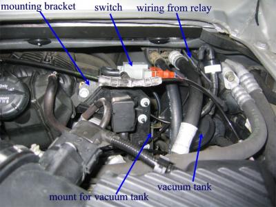

  5. When you have the electronics installed, just don't hook up the grey/pink wire to the relay carrier slot 23. That's the speedo wire that 'senses' the speed at which to close the vacuum valves on the mufflers. I just installed the electronics for the PSE and did the same thing. Here are some notes and pics of the install that may help you: http://www.belladessa.com/auctions/exhaust/exhaust.htm Jeff
  6. I just finished installing the PSE electronics on my '99 and did a quick brain-dump of what I did in case anybody else wants to do it. Don't laugh at my (lack of) HTML skills. Here's the link: http://www.belladessa.com/auctions/exhaust/exhaust.htm Feel free to critique. PS--this is for the newer style electronics (the 3.6 AND 3.4 version muffler).
