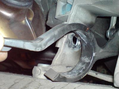

  7. thanks loren and ericinboca, the broken clip looks like it's at the position of #21 , but from the diagram, the shape doesn't seem the same. I have attached a photo of the broken clip. it is rounded with an extension on one end. Any part number for this? Is this the clip that attaches the lever that controls the angle of the headlights? Thanks guys.
  8. Is there a part number to this clip? Does it matter if this clip is not replaced? What is this thing anyway? It seems like there is a connecting rod that moves a lever everytime the control arm link moves. I am confused.
  9. it is a 2006 Boxster. Thanks.
  10. My Mechanic broke a black plastic clip supposedly link to a sensor lever that was hooked to the rounded end of the control arm link. What sensor is that and it was attached to only one side of the arm. I am trying to replace this piece before he completes the fixing, but I just couldn't figure out what part is it and what does it serve. Anyone that can enlighten? Thanks
