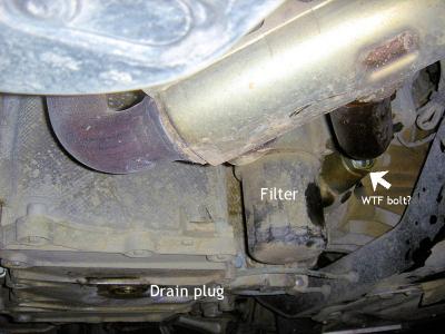

  3. Argh, I have a lot of rodents at my place, often in my garage. My alarm has gone off more than once when it senses them scurrying about. I guess I'll have to pull out the box of live traps. Side story: my wife put the cat in the garage to find the mice, so of course he found that a boxster top is the best cat hammock ever made.

  6. There's absolutely nothing you can say to make me feel stupider :P I actually saw a similar bolt about that size and in a similar location, referenced in something else I happened to read recently. I had my 8mm hex handy, I just got confused on a different procedure and as I said, as soon as I got horizontal I made a dumb decision -- which probably isn't the first time, nudge nudge wink wink ;)
  7. That's what I'm doing. Not going to risk a 50% chance of a $4k rebuild on a $500 bet (towing + service). Thought my odds would be much better, so I'm very glad you responded. Thanks again.
  8. With your 50% pooch estimate, here's my plan. Maybe you can poke holes in it. I'm going to remove the plugs, jack up one rear tire (chock front tires), and rotate the free tire with it in gear to see if there's any engine impact. That will turn the engine by hand, which presumably would not damage the valves if the timing was off. If it impacts, I have a shop that'll reset the timing chains for about $350 (plus towing). If it doesn't impact, I'll put the plugs back in and attempt to start it.
  9. Thanks for your help, JFP. I've seen your posts before, and was hoping you, Loren, or Toolpants would comment.
  10. It does look like a timing chain tensioner bolt (although at a different angle from what I've seen on pictures at pelican parts), so I guess the oil that drained from it would just be engine oil, which I changed. But apparently, that's the least of my worries. If it didn't jump timing, sounds like it should be fine. If it did, then I screwed the pooch and will have to replace my soon-to-be-bent valves. Any good way to check this without taking apart the engine? Can the PIWIS tell without starting the engine?
  11. If it adds any info, that bolt had a spring on it (which is when I did that wtf moment) but it was cool enough to remove but too hot to screw back in. It was designed to be bled. It doesnt seem like the tranny drain, though, since that is supposed to be on the bottom of the tranny pan.
