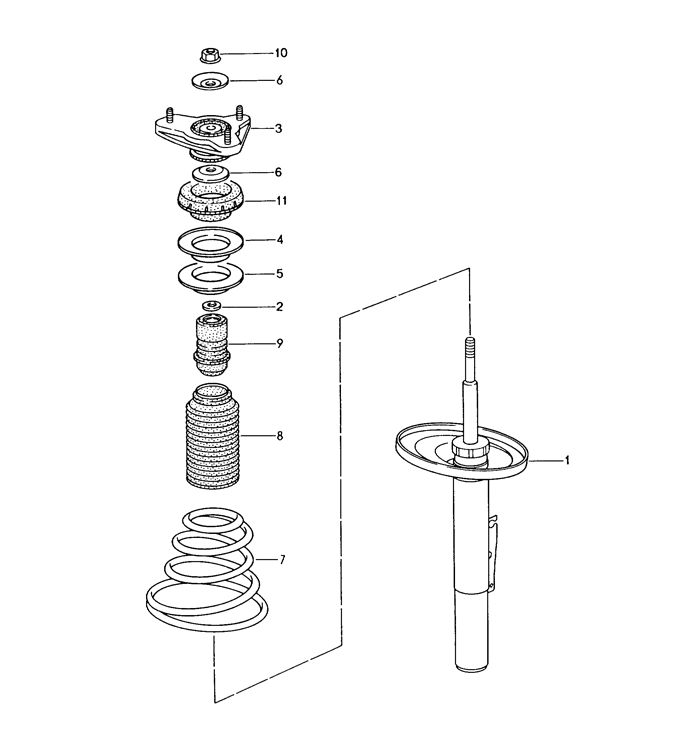

  3. While you're ordering parts don't forget to get replacement bump stops and bellows. They don't come with the kit. (Parts #8 & #9 in attached image)
