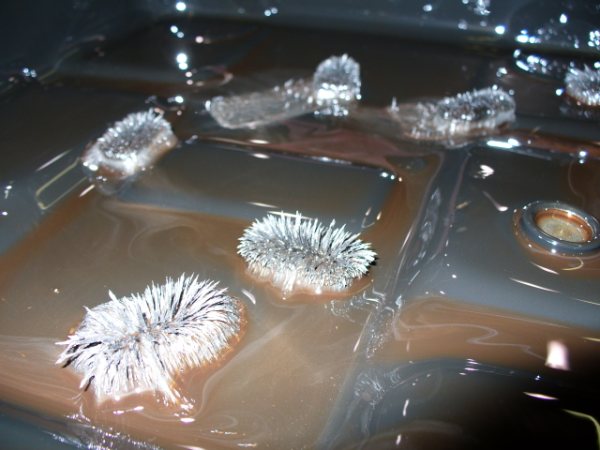

  13. not sure what material the metal shavings are or from exactly but here is a photo. Car is shifting better since the fluid change but under high torque and low rpm's (usually going up a steep hill) I have had instances of a shudder. Other times it will sound like it down shifts and the rpms go up however it stays in the same gear. It doesn't feel like there is much slipping at the moment.
  14. I have just had the 90,000 mile transmission service on my 2001 Boxster 2.7 tiptronic. Mechanic found metal shavings in the pan and was suggesting there may not be much life left in the transmission. Has anyone rebuilt a tiptronic S transmission or can recommend a reputable rebuilder in US or Canada and what a reasonable cost would be to expect? thanks
