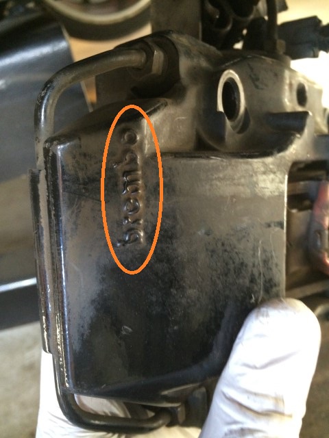

  4. I just did a rear wheel bearing on my '99 and found the Brembo name or logo cast into the caliper, the hub and upright - along with the familiar Porsche logo. I was only surprised that this wasn't mentioned in my "Porsche 996, The Essential Companion"..then again I could have missed it.

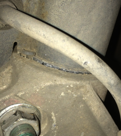

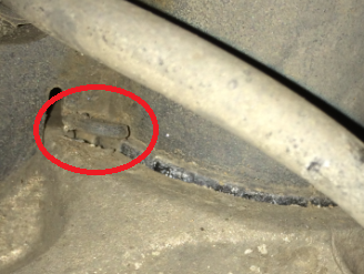

  10. Is the wheel carrier supposed to rest on this (circled in red) tang that's on the strut?
  11. '99 C2 996 I replaced the drop links on the front of my car and as I was tightening the upper bolts - which is the pinch bolt for the strut - I wondered what was keeping the strut in place. I decided to take a picture of the top and it seems that they moved slightly. Is this a problem? Should I have removed the wheels beforehand?

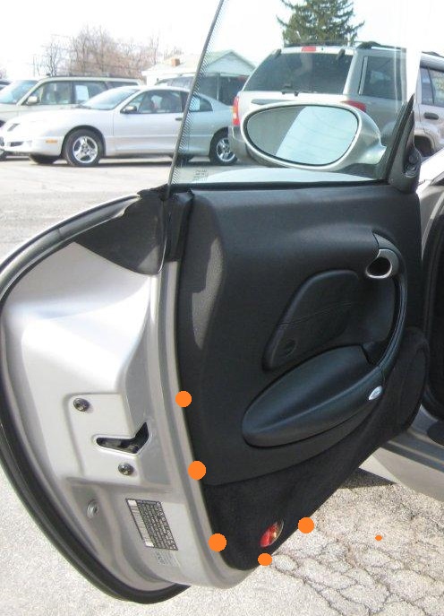

  12. Got the clips and there is a subtle difference between the 2. 999 507 505 40 Grey clip exists on my car on the upper part of the door panel - above the carpeted area 999 507 582 40 White clip -- I found these only on the carpeted part of the door panel
  13. Sure enough, I tried to remove one today and it was so brittle it broke. Now there are part numbers for white and grey. My panel seems to have both colors installed. Is there a difference other than color?

  15. It looks like the clips that hold the panel on are there, but not working properly. There also seems to be some foam perimeter seal along the edge that may be preventing them from fully inserting in the metal part of the door. I thought at first in might be the weight of my 9mm in the armrest bin, but I moved it and the panel still comes off. I found the posts on door panel removal, but nothing that has addressed this issue. Thanks
