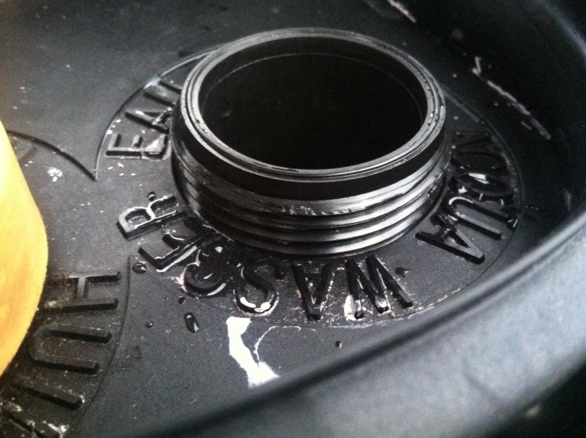

  5. Guys, I recently replaced my coolant tank but forgot to get a new cap in the process and I still had a leak. I have a new cap ordered, but noticed that the threads on the tank were a bit rough in a couple of areas. The image shows the worst area, on the other side is an area with just a tiny bit of roughness. I assume this was done when installing the old cap on the new tank. Question is, will this damage the new cap or perhaps keep the new cap from sealing the tank? Any help is greatly appreciated.
