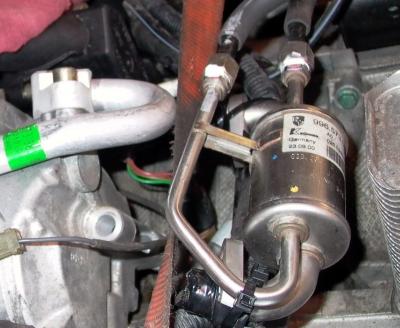

  13. Oh, there is a fuel cooler alright. 996-573-069-01. It is mounted to the ac compressor suction and is located under the intake. It's shown here with the wrong pipes.
  14. Due to a recent modification to my car, the fuel cooler will not be going back in. Clearance issues. How important is the fuel cooler and what are the ramifications of running without it?
