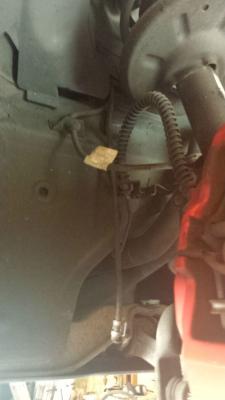

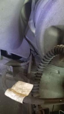

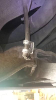

  4. I just finished the 90K on my 2002 Boxster S. A couple of items I'm chasing and hoping for some ideas: 1. I recently replaced the window regulator on the passenger door when the window stopped dropping to open the door. The new regulator fixed the problem - for a while. Now about 2-3 months later, it's erratic. Before I rip the door apart again, any ideas on what I should be looking for in there? 2. During the inspection just finished, I noted a tube (with a clip still on it, and it's end melted) hanging down near the brake on the front right. It wasn't causing any problems, but I have attached some photos in hopes of someone being able to tell me what it is and what to do about it. Thanks John
