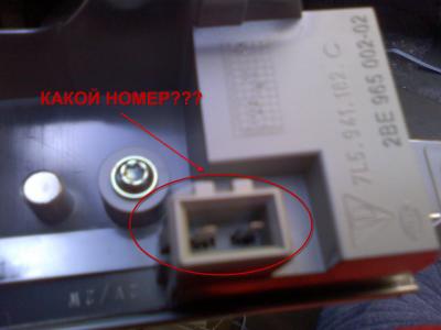

  1. You need the caps for GTS/Turbos: 95562830311G2X 95562830411G2X
  2. What about wiring housing? you have ordered new front wiring from Porsche or just order the wiring housing from VW Touareg?
  3. The control unit in S the same as in GTS/Turbo. Yesterday (04/17/2009) we have installed the Turbo bumper with turbo lights (the wiring housing for LED was taken from VW) . I have just connect the wiring to new housing without any mods with PIWIS. Everything works fine (but as for me for whole GTS retrofit facelift it nessesary to install GTS front lid air duct 95557542350, 'case the S air duct not the same as GTS - especially the top).
  4. Hi! A few my friends make the the same mods as you, one of them told me, that just connect DRL with new housing. Thats all
