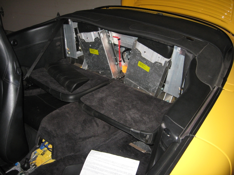

  8. Thanks very much Loren. BTW, just donated. EDIT : Is the photo you posted for a 996 or a Boxster? I removed the six T40 torx-headed bolts and moved the passenger rollbar assembly to expose the area beneath it. The relay carrier is not there! This has turned into the case of the missing relay carrier. Where else could it be? The car is a 2000 996 C2 Cab. Thx.
  9. Can anyone help me locate the relay carrier #2 that holds the relay for the engine compartment fan? From the research I've done here and other forums, the location for a cabriolet is NOT the same as a coupe. Attached is a photo taken of the area behind the rear seat backs. Thx in advance. - Doug
