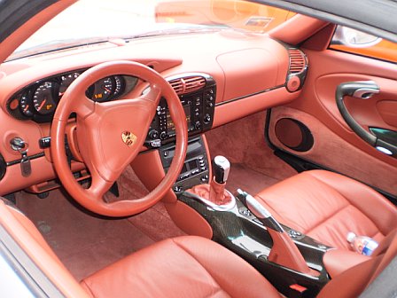

  2. I just did this on my 01 996 Turbo a couple nights ago. Once I removed all of the screws and the side cover to the emergency brake, I had a tough time getting the console out, even with the passenger seat all the way down. I couldn't get the right angle to get the front part of the console out from underneath where my ventilation and seat warmer controls are. When I finally got the right angle I noticed that in my many attempts to remove, I had really torn up the leather at the base of my hand brake! :censored: :cursing: The pictures were taken before I replaced the hinge. You can see on the driver's side photo where the leather has a blackish smudge, the leather to the left of the smudge is the area that got affected. So now, when the brake is engaged you can really see how bad it looks! Man, for something that was supposed to cost me $30, I'm not sure how much this is gonna cost to fix! Sheesh! I found replacement hand brake levers, but they're priced between $200 and about 4 to $500! OUCH!!!! And they weren't even in my color combo! I feel so bad about this! Maybe an upholstery shop? Anybody know any good ones in Chicago, IL? On a side note, I priced out the hinge replacement kit, the cheapest Porsche part I found was for $22.50. With shipping it would have been closer to $30. When I called my local dealership, they told me $38, I asked if they could price match, he said he couldn't go as low as 22.50, but he could do $28, so my out the door price was $30 and some change. Never hurts to ask!
