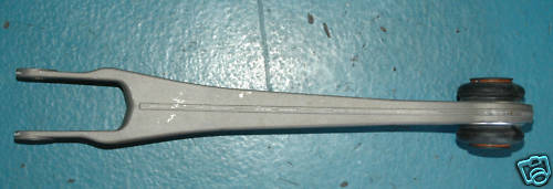

  23. Thanks! Will go ahead and buy replacement arms for both Front and Rear.
  24. I was hoping you'd say that, cos that's the only bit I need to change and I'd just completed the whole PSS9 installation and big brake kit installation, and didn't want to go through it all again! Do you think it is also an easy replacement for the rear ones? Thanks in advance!
  25. If I need to change just the front control arms ("tension rods", not the lower arms), can this be done without removing the rest of the suspension?
