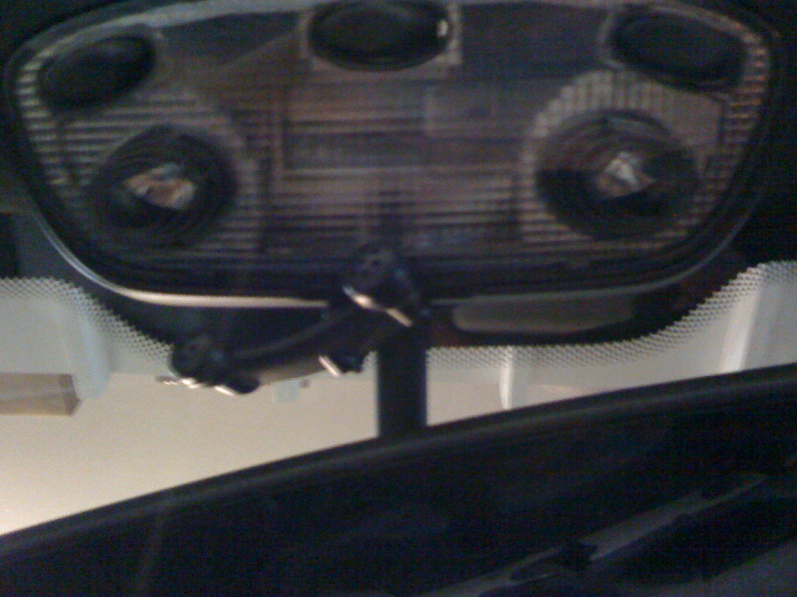

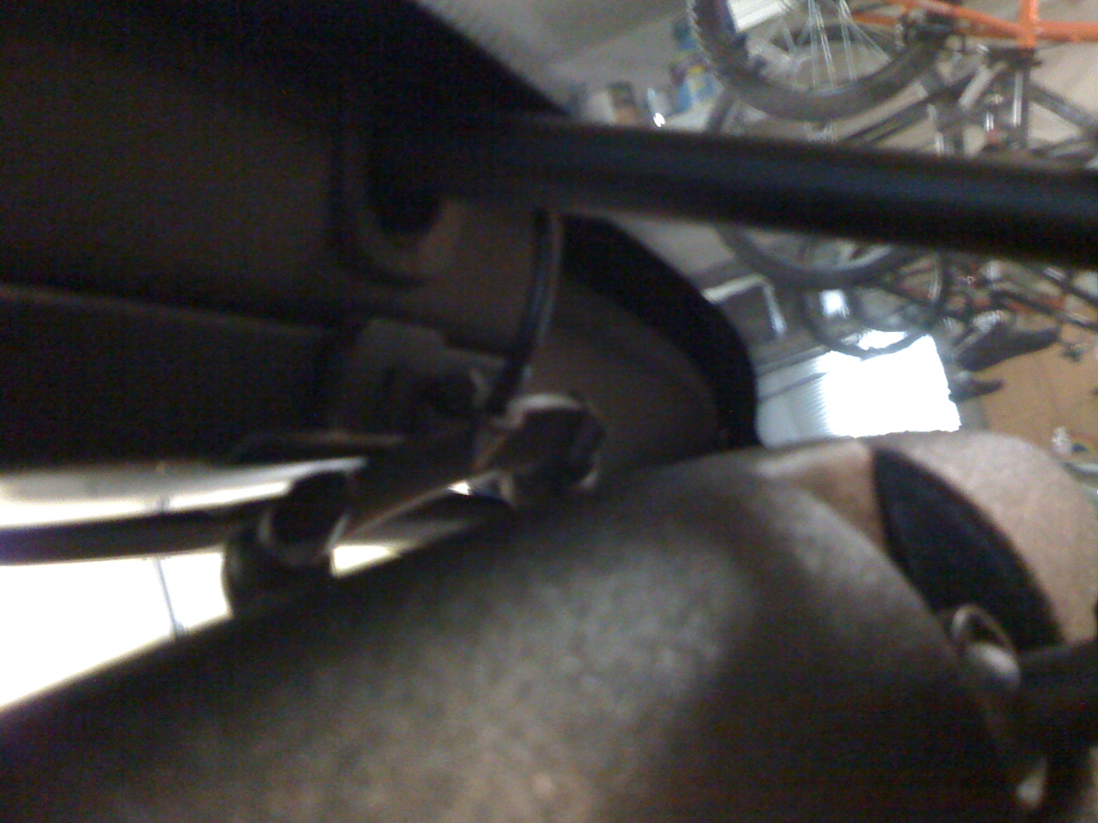

  4. Here are a couple of pictures showing how the mic is mounted now. Thanks for your replies - between them, other forum posting and the mObridge instructions from the website the install was quite simple and completed in less than an hour. The box itself is mounted just behind the glove compartment - a location easily accessible from the passenger footwell without taking out the glove box. The iPhone cable is routed to the center console and the mic cable hidden behind the windshield trim. Looks quite clean and works like a charm!

  7. Just got my Mobridge Bluetooth for my 2006 C2S Cab and eager to install it. The tips on mobridgeinc.com regarding where to put the box are quite useful and I am planning to locate it in the center stack behind the PCM as described there. I am having a hard time finding tips or instructions on where to locate the microphone and how to route the wire though. Anyone done this before and can share some tips? Maybe even a picture?
