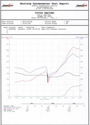

  14. Has anyone seen a excel spreadsheet xls that can draw graphs using Durametric software data for tq/hp/afr, Brockway uses there or odb2 port to take even it think NB O2 sensors and figure out what your afr is etc with out wideband sensors on a gauge etc. The only one I have found in .ZIP form that maybe can do it by importing excel data but have not got it to work as of yet. Need a way to show this data like a dyno graph, trying to find out what issues are causing these 5000k issues on my graphs. Log file Interpolation ver3p7c Jan08.zip

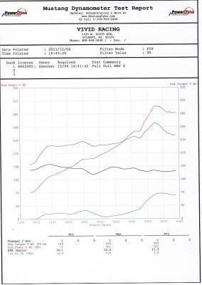

  16. My car (2000 996 manual) goes in for dyno testing using a Mustang Dyno and need to take O2 readings and was wondering if my cats have an extra hole in the pipe for a wideband sensor that can be used. I think I recall seeing a plug in one of them awhile back.

  18. Waiting on new SC pulley belt which just found out today was lost by post office however will let you know when I get results. I have some original excel Durametric spread sheets to use as comparison.
