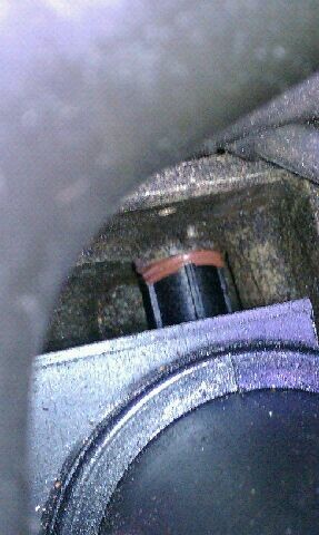

  17. Hey guys..Thanks for the response! Well initially I did clean the intake, throttle body and the MAF...As far as the special grease, I asked one of the guys at Sunset Porsche about it and he said I didn't need it , just use engine oil. I guess I'll clean out the throttle body, intake and reinstall the AOS with new grease. I attached a pic showing the O ring..It seem to come out a bit. This O ring should be totally pushed in, correct?? Again, thanks guys..
  18. Hello All, I recently change my AOS about two weeks ago and the car was driving sweet. No smoke and the performance was on par. As of yesterday I saw some smoke and the car doesn't seem to drive as well..Slightly. Today I see a heavier smoke cloud on initial start up. When I did the install I had lots of difficulty getting the small O ring on the bottom of the AOS to slide into the block. I lubricated it with engine oil. I got it in a far as I could but I visually could see it protruding outward.Today I inspected the bottom O ring and it seems to have come out just a bit more. Is this the source of my problem or could it be something else? If so, can anyone give me any tips to securely get it in??? I tried extensively and couldn't get it anymore than I did cause of the lack of space. Is there a better lubrication I can use? Anyone have a pic of showing the O ring properly installed? Any tips would be super appreciated! PS: I tried to take a pic, but my camera is acting up! :(
