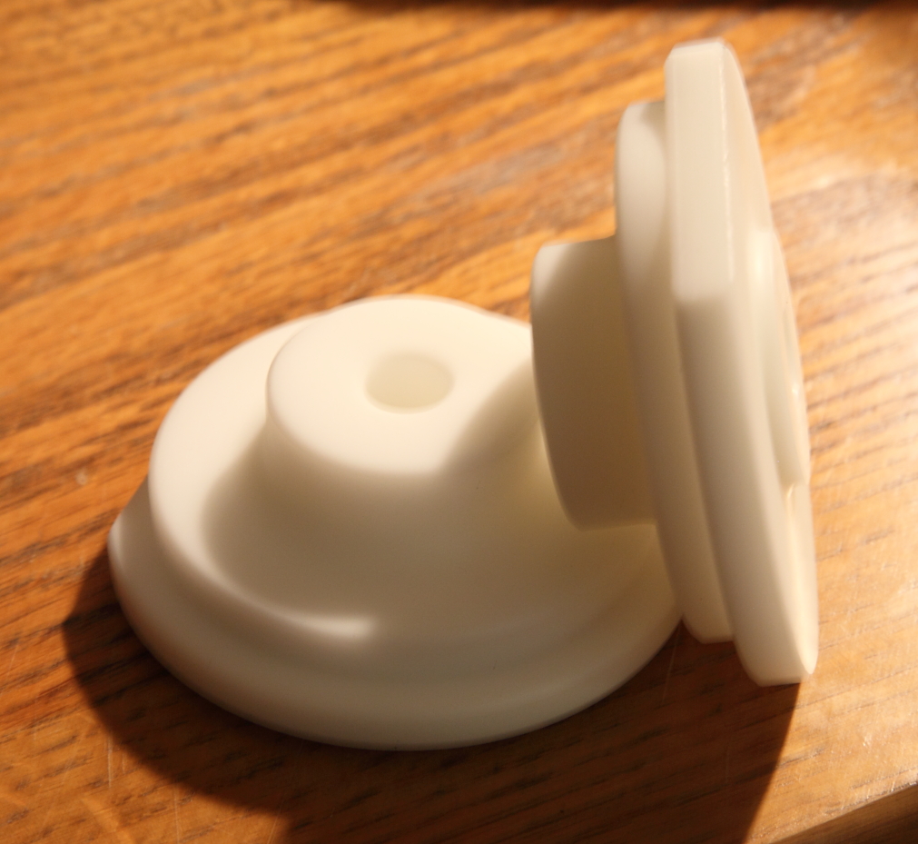

  20. I bought these solid mounts when I was upfixin' a 993 a couple of years ago and now that I've sold the car I want to sell the parts, but can't remember where they went on the car. Anybody recognize them? Thanks, Mike
