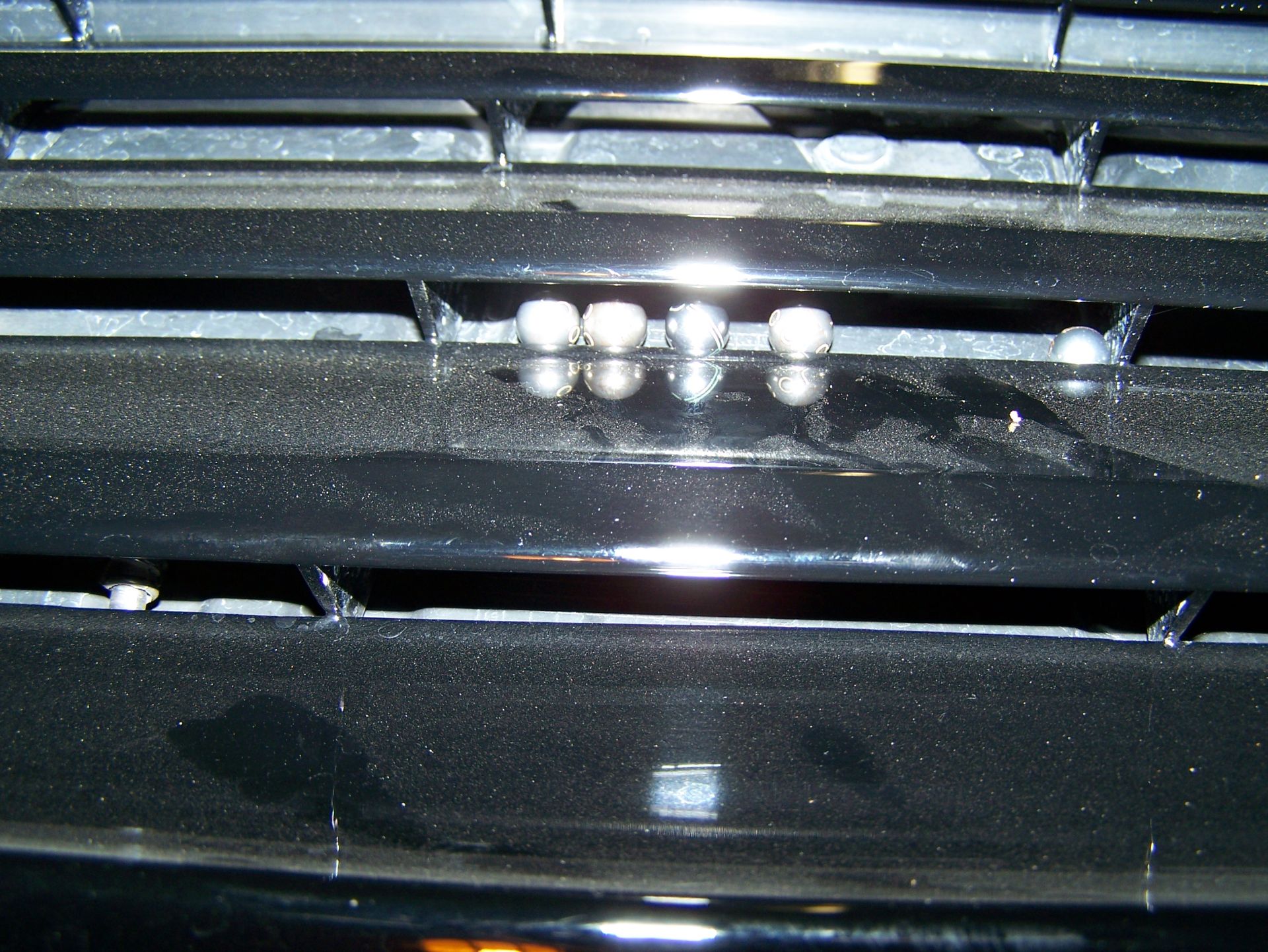

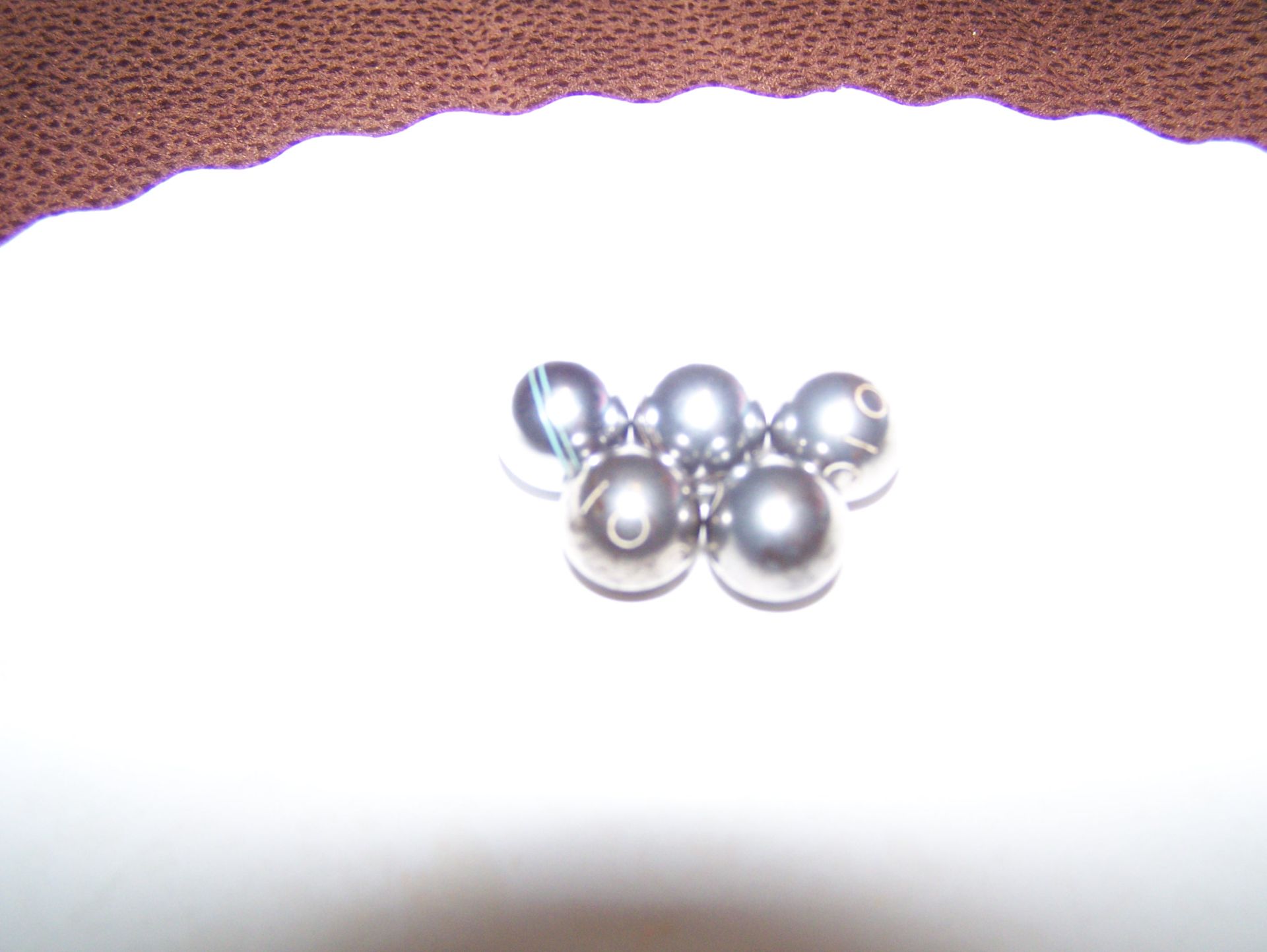

  4. About a month or so ago I found these bearing balls outside my 05C2S rear spoiler. See first pic. I thought some jealous person put them there back then. But now after reading all the posts about issues with these 05C2S and my gear not changing issue, I'm thinking these came from the engine compartment. I'll take my car to the mechanic this coming Monday to get the gears checked and I can ask him about these bearing balls then as well. But I just thought maybe some of you might be able to tell me where these bearing balls go? One ball has markings of two lines in the middle with a letter D like this ====D====D Three balls have markings of an I then three Os like this I O O O I O O O One ball has markings of two lines in the middle with a symbol that looks like @ with ai like this ====@ai====@ai Any thoughts? Maybe I'm just being paranoid! :jump:
