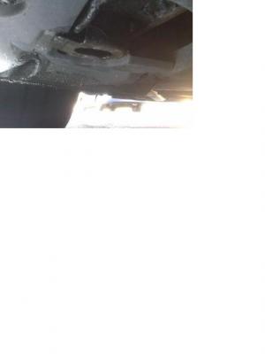

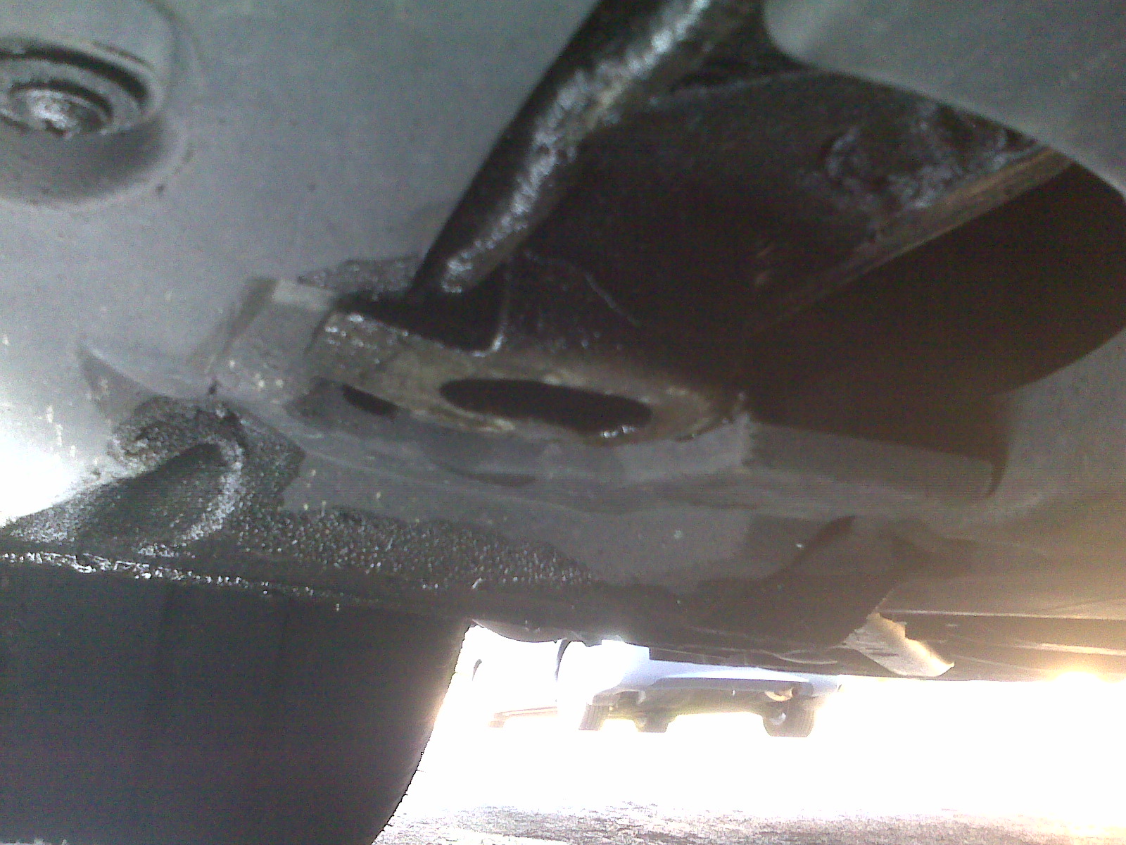

  8. Confirmed. The oil leak was caused by the hydraulic cylinder for the convertible top.
  9. Do you have a part number? Did you ever find this part number and price? They cost around $800.00 each. 1 cylinder fits both side.... no right or left.....what a surprise :D
  10. I guess that would be the answer for mine too. The cyclinder sits right above the water collection pan, and there is a linkage leading outside of the car. That's exactly where I had the leakage. Do you happen to know the Hydraulic cyclinder part number?
  11. Hi, I have a leak around the wheel well and my top just top working. Is that where the oil leak for your car? thanks,
  12. Oh no. The convertible top can't open today. It could be the e-brake sensor or may be due to the " strange oil " leak. Keep my finger cross nothing serious. Weather is so good in Toronto. I am missing it... .
  13. It was quite difficult to check the power steering oil level, but I suspected that was it after comparing the oil drop on a white piece of paper with the Hydraulic oil. They look almost the same color. If the leak was water base, the stain should dry on the card board overnight, but it didn't. I will discard the possibility of coolant for now. I will try to follow the hydraulic line to see where it lead to. thanks,
  14. I realized that my charger had an option for 2A charging current for that purpose. I will consider charge it up once a month during the winter time. Beside, I am planning to install a battery protector soon. Maintenance free does not mean it shouldn't be maintained (ha ha ha)...Typically MF means there is enough electrolyte to maintain the proper performance for the life of the battery. On some of the MF you can still add water (distilled), but it appears this is not an option for the Optima. It is a battery and will lose power if there is any drain...so the maintainer will keep the battery well charged while the car sits and no alternator to charge it...It is better to maintain a MF battery with a slow trickle charge...to prevent gas build up.
  15. At first, I thought it was water came out from the waste drainage hole. But after a full day of sunny drive, it was obvious that these weren't water, they are oil. Question is what type of oil. The position of the leak is in front of the engine, and I didn't see any motor oil leaking from the engine when I jacked up the car. The color of the oil is quite clear and carry a very light green color. I suspected that it could be hydraulic oil. Any thought would be helpful?
