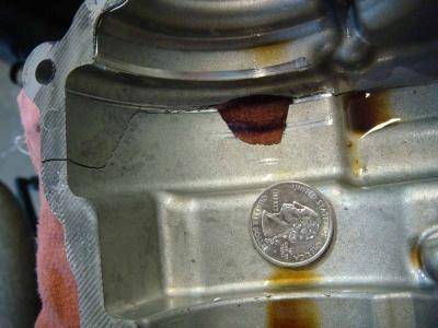

  2. Attached are pictures of the damage... 1st pic: hole in cover is visible in the bottom left of the image 2nd pic: close-up of hole 3rd pic: seized oil scavenging pump 4th pic: close-up of seized pump 5th pic: failed pump drive
  3. Here's a summary of the problem from the dealer (2005 997 C2, 70k miles, 3.5 months out of warranty): As I mentioned on the phone, during our road test we’ve discovered the engine had a major oil leak from the valve cover. We then lifted the vehicle and found a hole in the valve cover. (I took pictures and put a quarter to relate the size of the hole) We then removed the engine from the vehicle to further diagnose the problem. We have discovered the oil scavenging pump for bank 1 has seized. The pump has a drive that goes into a notch on the end of the camshaft. The drive and notch have broken into pieces from the pump seizing. There is also damage to the timing chain and chain guides. To repair, we would need to replace the cylinder head due to the cam bores/bearings are machined and center cut to match. We would need to split the engine case to replace the damaged timing chain. The total parts for this repair alone cost $5500.00 and the 30 hours of labor is $4950.00, making the total estimate $10,450.00. Anyone else ever see such a failure on their 997-1?
