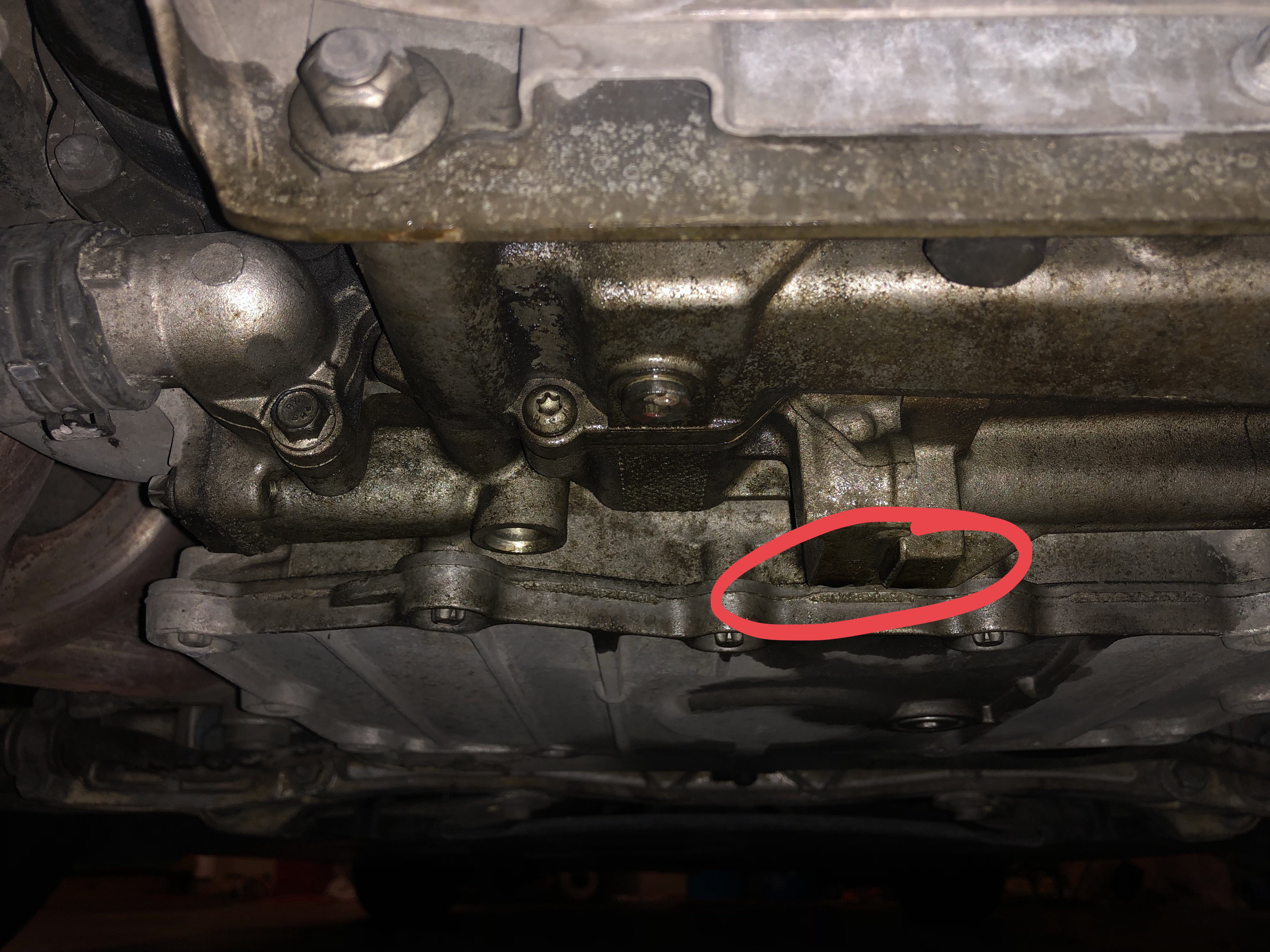

  5. That was good advice, and my mechanic had me do the same thing. This turned out to be the rear main seal. All fixed now!

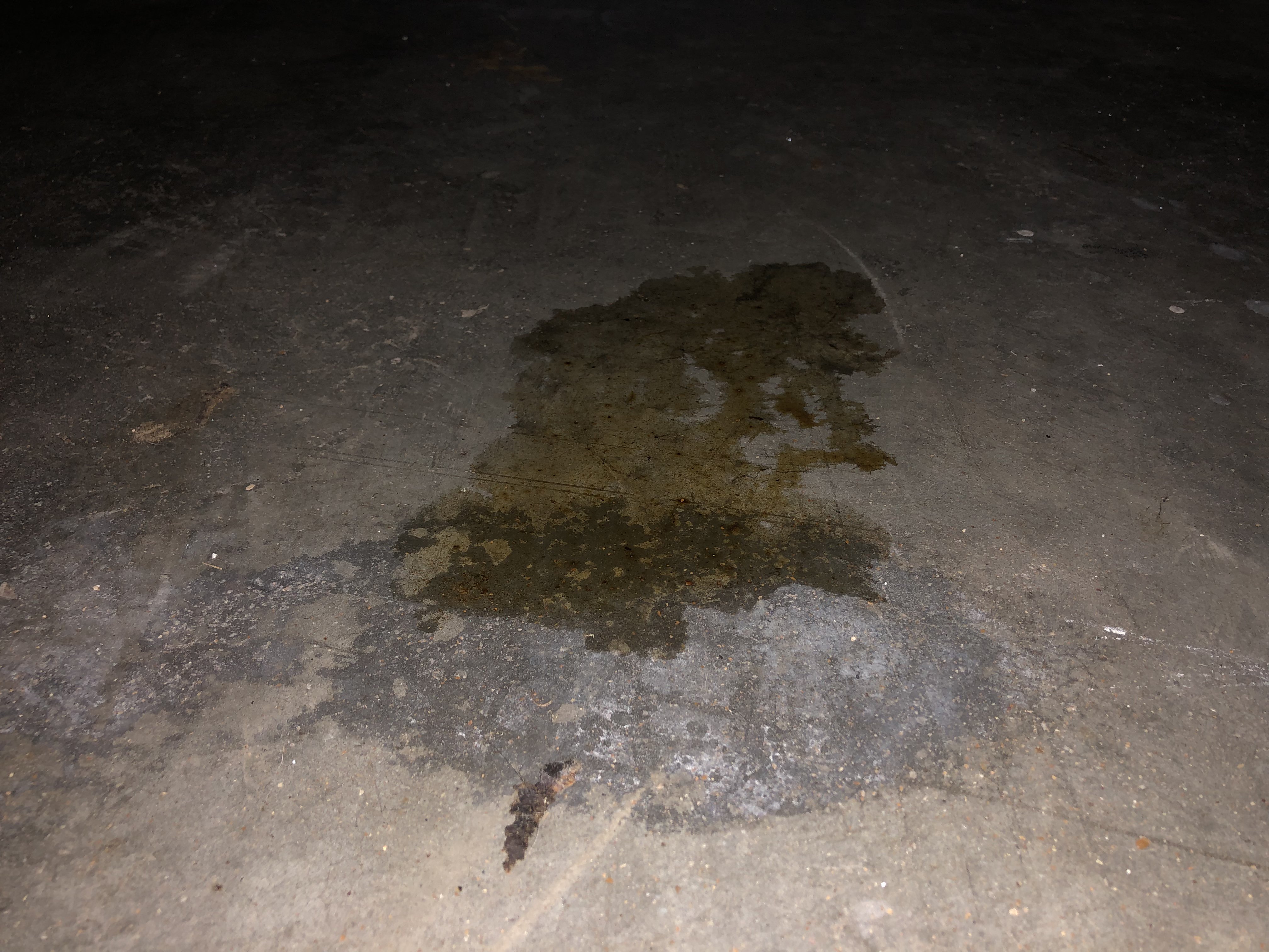

  6. I’ve discovered an oil drip from the back of my car. This is immediately following having the Oil/Air Separator and all pulley’s replaced so I’m thinking it’s likely related. Work was done at a trusted shop. This is a 2008 Carrera C2S with about 89000 miles on it. I took several photos and circled where the oil is dripping from. These were taken after the car had been sitting in my garage for about 36 hours, and the oil level is measuring as better than half. Anyone have any thoughts?
  7. Update: This turned out to be the oil/air separator
