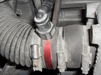

  12. I mean the little plastic tube attached on the red ring. It's the same red ring on the other side but no pin for connection. The plastic house is going up to the engine compartment. (I saw this then I change the sparkplugs and got intressted what the function was for.)
  13. Anyone that knows what the function with this plastic tube ahead of the turbo charger at the driver side? It's nothing at the other side.
