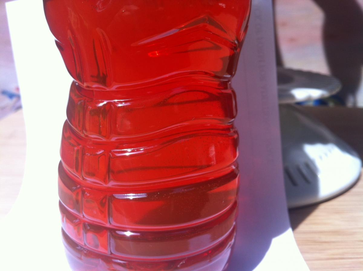

  3. Thanks for all of the responses. I really appreciate the help. The coolant I removed is more orange, not as dark as I initially thought. However, it's not the bright pink that the factory fresh stuff is and that's what worries me. To me, the color is consistent with adding a bit of contrasting color, green, to the pink. Just as DBJoe996 suggests. It looks clear and I do not see and drops of oil in it. I've attached a picture for further consideration.

  5. Okay, so I think I may have run into a bit of a snafu. I checked the coolant level the other day and it was fine, but the coolant itself looked rather dark, so I took some of it out to get a better look at it in a clear bottle. Next to virgin coolant, the stuff I took out of my coolant resovior is somewhat browner. It's not as bright pink, more of a muted pink color. Is this something I should be concerned about? The temp seems fine when I drive (doesn't go past the right edge of the 0 on the guage). I'm wondering if oil has somehow found its way into the coolant or if its just old stuff that didn't drain out when I drained to replace the water pump. Any advice is much appreciated!

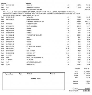

  19. Just returned form the shop. I met with the mechanic and he walked me though everything. My car was on the lift with the transmission out and the cam adjusters removed. He showed me one cam solenoid/actuator unit that he had out and it had fairly deep grooves primarily on one side. He said that he planned on replacing the chains and spark plug tubes/rings as you suggested and showed me the parts pile he had assembled for my car. He showed me the IMS bearing he removed and it looked pretty bad. He said I was lucky that it was only a matter of time before it failed. He showed me the clutch plate and it was really worn, almost down to the rivets. I went through the parts list he had and he agreed about the things your pointed out, logray. He said it was the secretary who entered things wrong but that it would definitely be fixed when the work is done. He's also going to replace the AOS and timing chains. I suggested that I purchase my own parts and bring them, but they kind of have you over a barrel because if I did then the labor rate increases. C'est la vie. Or should I say das ist Leben. I can post pictures if anyone's interested. The work should be completed next week. I'm really looking forward to it. Now, I just need to sell a couple of my favorite watches to pay for this (Tag Heuer Monaco and Bell & Ross 03-92)!

  21. So, the saga continues... My mechanic called today and told me it's the variocam adjusters, not the solenoids that need replacement. This hikes the job up pretty significantly. He tells me he would also like to replace the clutch while doing this saying it will only cost the amount of the part, but labor would be the same regardless. So, now the price is $6637 ($4484 in parts/$1575 labor) to fin the variocam adjuster units (x2), new IMS, new RMS, new clutch, new spark plugs, new ignition coil, oil/filter change and various other new fluids. I've attached the estimate for anyone interested. The only thing keeping me positive is knowing that the Porsche dealer doesn't have my car because they would have really charged me a small fortune! I'm going to meet with the mechanic tomorrow before he starts working.
