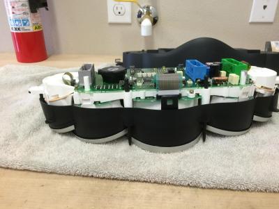

  15. Thanks, but I have the newer cluster, and it appears the bulbs are soldered onto the pcb motherboard. I guess if there is a bad bulb, you have to replace the instrument cluster from what I can tell.I wish mine was the older style cluster. Maybe Loren might know if my assumption is correct?
  16. I have read all the threads here on how to access and replace the instrument bulbs, but I may have a different cluster. My car is a 2003 and the instrument cluster looks different inside from photos posted here. My cruise control doesn't work (no green light when button is depressed), so I am hoping it is the bulb. I understand if the bulb is bad (open circuit) the system won't operate. In the attached pictures, do I have to remove the circuit board to get to the bulbs? I believe the cruise control light is behind the speedo? How do I get to the bulb? I don't want to go much further, as there are a number of ribbon cables that would have to be removed. Thanks!
