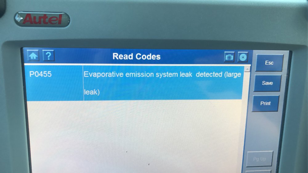

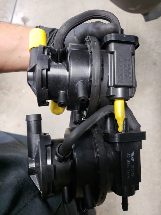

  5. 2009 cayenne S (US spec) with 74k miles on the clock. Check engine light on with code P0455 (evaporative emission system leak - large leak detected). Picture attached i took it to a shop to do a smoke test, they found no external leaks. They tested the tank vent valve and leak detection pump and it failed twice. (Pic attached) so i changed the leak detection pump (95560510702), found that the one installed was a chinese brand not oem, drove the car for two days then the light came back again! Same error code. next step i want to change the tank vent valve (95560524101), is that the same as the purge valve? i found some DIY for an 03 -06 TT but not sure if it's the same for my 09 cayenne S. i can't find any diagram online on where the valve location is. Any help is appreciated, thanks.
  6. Gents need your feedback please: Bought a 2009 cayenne S (US spec) with 74k miles on the clock. It had the check engine light on with code P0455 (evaporative emission system leak - large leak detected). Picture attached i took it to a shop to do a smoke test, they found no external leaks. They tested the tank vent valve and leak detection pump and it failed twice. (Pic attached) so i changed the leak detection pump (95560510702), found that the one installed was a chinese brand not oem, drove the car for two days then the light came back again! Same error code. my car starts perfect when i fill up the tank, i was considering still changing the purge valve , is that the same as the tank vent valve? dunno where else to look, my fuel cap is updated and the smoke test would've shown it to leak if it was faulty... any feedback is appreciated

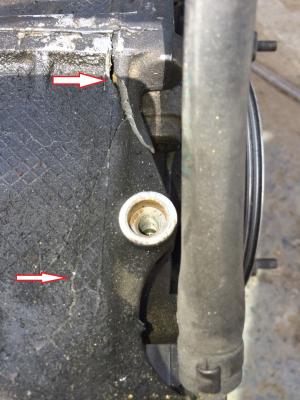

  15. An update regarding the problem with my engine. attached is a photo of the cracked engine block. the block was completely cracked throughout the middle. I have no idea what might've led to this, I have since sourced an engine and fitted it into my car. the car is happily back on the road. thinking of dismantling the old block to see exactly what went wrong, any good DIY on how to tear down the block? Thanks, Nehme

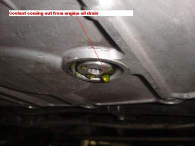

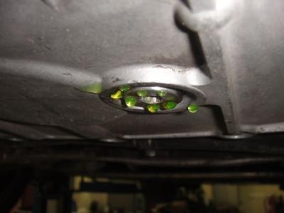

  18. Hi, 2003 996 C4S 146,000KM on the clock. i haven't driven my car much this past year, only 4,000KM (2,500 Miles). I always maintain my car properly and change oil religiously... while driving with the Porsche club, and without no temperature rise, i heard an explosion in the engine bay, the car stalled and the whole dashboard lit up. when i opened the engine bay, coolant was all over the place... photos from the independent workshop show that the oil reservoir is filled with coolant... Hydrolock is suspected with all possible scenarios being gloomy... would appreciate your input on previous similar experiences... could it be only a failed AOS and not a cracked head or engine block?? the workshop will charge me around 1,300$ for investigating the problem, which will not be charged if i decide to go ahead with a top end rebuild or whatever the diagnosis is... Is it worth investigating now, or i can leave the car parked for a while without any consequences? Is the coolant inside the engine bay terrible in the long run? would it be impossible to clean out if left inside? thanks, Nehme

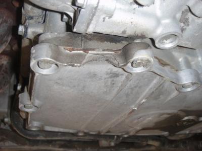

  22. 2003 C4S 142,000 KM lifted the car yesterday and noticed that the oil sump has some sort of moisture on it and part of the sump is broken/damaged. i attached a couple of pictures, not sure if it is leaking because i didn't notice any oil traces in the garage, can i live with this or do i need to change the oil sump? thanks, Nehme
