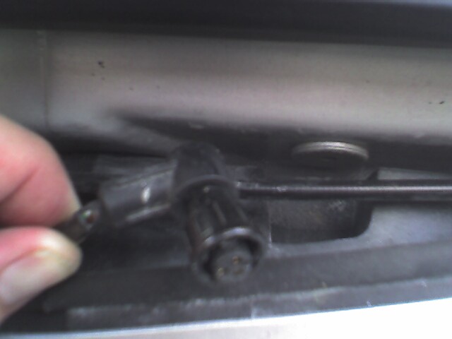

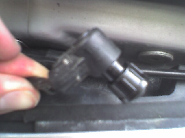

  4. Could this be from K40 Radar? Previous owner (family member) did have it installed... Just thought of it now.
  5. My bumper was re-sprayed a few months back and yesterday, while adjusting the hood latch, I found this connector unplugged and laying underneeth the hood latch. Car is a 2000 C2 Cab. Can anyone help me identify it and let me know what it does and where to plug it in? Thanks in advance!
