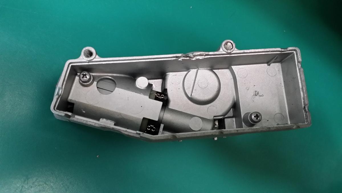

  1. The answer so far is yes. Here's the upper steering shaft and column with the switches and steering wheel removed. The ELV has been removed from the column, although I did some damage in the process because I couldn't tell how it came apart and there was nothing online about it. This is the top of the lower shaft and the rubber boot still installed. They came apart fairly easily, so I anticipate the new one will slide right back into the boot/lower shaft coupling. As long as that works then it's possible to skip the whole "disassemble and remove half the exhaust header" step. Had I not mangled it in the process of learning how it was put together I could have attached a replacement ELV directly to the underside of that column without removing it. It would have still required the dealer to reprogram it, but it would have been a 1 hour job.

  3. Has anyone replaced a steering column? According to the manual I have to remove the primary driver side cat to remove the rubber firewall piece and the lower section of driveshaft to the U-joint. However, the shaft comes apart in the middle at that rubber boot. Is there any reason that the new upper shaft and column can't be coupled to the old lower shaft and u joint? There's nothing wrong with the steering column, it's a steering column lock issue. On that note, some pictures for people that work on this part in the future. The lock is removable fairly easily. The manual is not correct when it says that none of the parts are removable. You may still need to buy a whole new or used assembly because the parts aren't sold individually, but I'll show you how to get it apart. See these knobs? They're screws with no heads. They aren't in very tight and can be removed with vice grips, or by using a dremel tool to notch them for a screw driver. Remove those, then wiggle the cover off. The lock has one coupling bolt that is only accessible from below when the lock is unlocked. Once it's unlocked (retracted) there is a hole here: Unscrew that, and the ELV or steering column lock will come off The lock is 4 parts. There is a metal cover, a back plate, a circuit card, and a motor/gear assembly. The back plate pops out if you get a chisel or flat head screw driver between it and the rest of the case. The card slides out from there. This is the motor/gear assembly. You can test it with a 9v battery to make sure the motor and gears are still good.
  4. Yeah, the first one is the one I've been using. The ELV A2 (supply) to A3 (ground) is reading 0VDC. I think it should be ~12VDC when the key is in the ignition. A1 (data) to ground is ~12VDC. SO far I haven't actually found the kessy module. The picture doesn't convey how many other things are in that general area. I have a replacement column and the kessy modules are fairly cheap. Perhaps I'll replace both and see if the dealer can get them programmed together. But I'd feel a lot better if I can narrow it down to what specifically is wrong before I have it towed to the dealership.
  5. Sorry, that's actually for the power adjustments. This is a module under the column that locks the steering wheel in place when the car is turned off. I found a good diagram for it, but I'm not seeing power on the supply side of the connector. It seems to be powered from the driver identification control unit. I need to locate this and see if there is power on the output to the column. The motor and gearing that actually lock the wheel are good. So it is either a fault on the board in the locking module, the control unit, or the wiring is broken somewhere. Sadly there is pretty much no information out there on this part of the car. The usual answer is replace it all at the dealership. However, I'm not even sure which really expensive part needs replacing. My local dealership is incompetent. I'd end up paying them to easter egg around the car replacing anything they can get their hands on. Does anyone know how to get at this driver control unit? Is it the same as the keyless entry module?

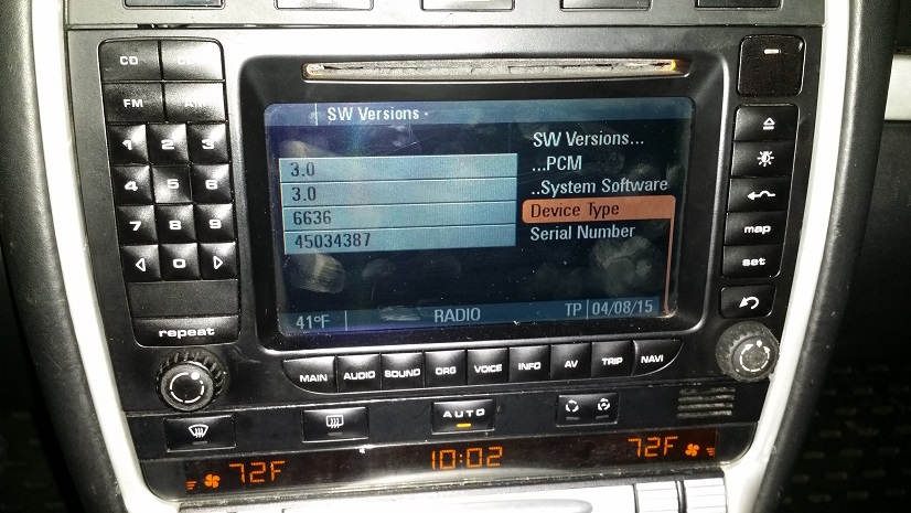

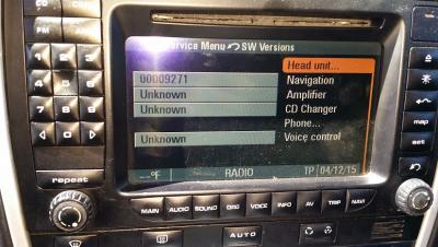

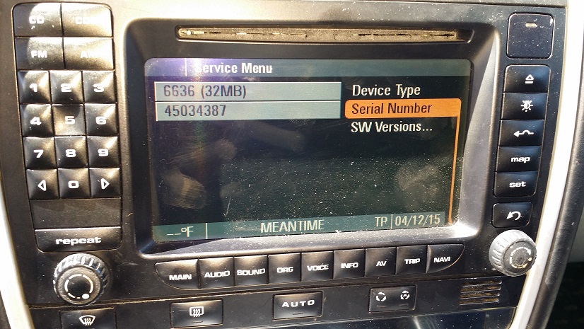

  10. Similar to Jeppe's, but I didn't want to hijack his thread. I bought a used cayenne, and the non-Porsche dealer replaced the NAV unit with a OEM one. The sound was working originally, and they could not get it working after the repair. I have attached a picture of the error message. Various methods to reset the system have not had any effect. I read that it is either a bad component (amp), bad connection, or quite likely a software issue where one or more components need a software update. I tried following this post http://www.renntech.org/forums/tutorials/article/268-summary-of-pcm21-updates/but it doesn't quite jive with what I'm seeing. I pressed trip+main and got the attached screen, and I can scroll up and down, but I can't get any more information or sub menus to come up. I've also attached a picture of the CD that was in the NAV unit. Any PCM gurus out there that can point me in the right direction?

  12. I think it's actually simpler. They have some aftermarket windscreens around the front and rear windows, which I think are stretching the rubber out a little bit. The whole rest of the door lines up nicely. They have also installed a similar screen in front of the sun roof. I'll probably just remove them all and see if that fixes it. I decided to buy it because 14K isn't bad for a CTT, and I like projects. The next one is hacking the most system to update the software and get the amp+CDC working. Anyone know how to pull up software versions? I read something about pressing multiple buttons at once, but apparently it was not the same version of the PCM so it didn't work. Sadly the durametrics doesn't seem to interface with the MOST/PCM systems at all.
